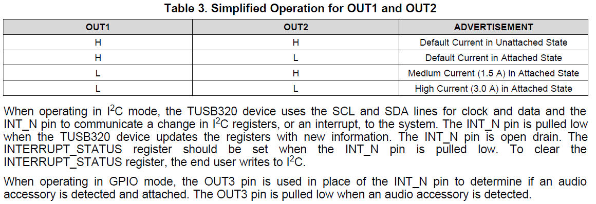

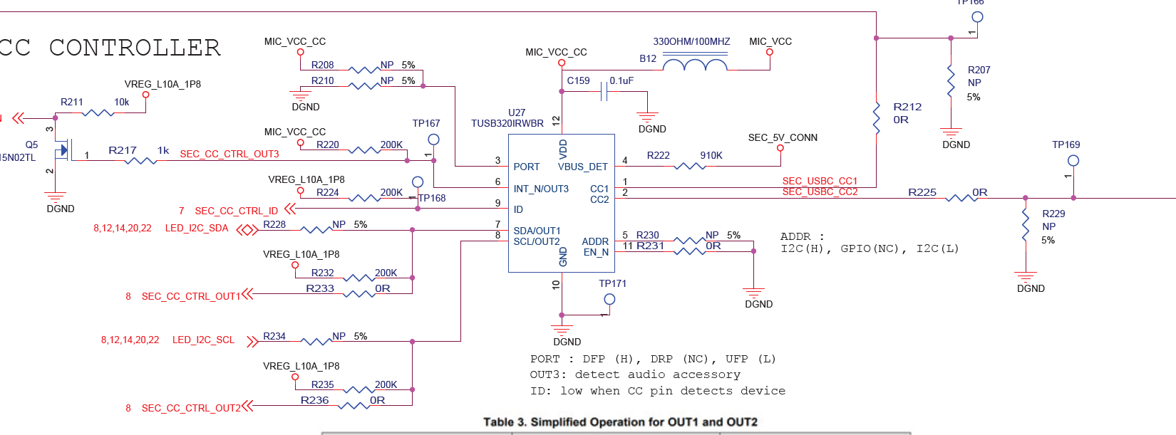

Dear members,
The pin7&8 of TUSB320 can be configured as I2C or GPIO mode by ADDR pin, we'd like to confirm with you about the Table 3. Simplified Operation for OUT1 and OUT2' in the datasheet. Due to this CC-controller is connected type C connector, we want to know need plug-in which type C device/adaptor then to we will measure the OUT1 and OUT 2 behavior and charging current is meet spec defined or not.
