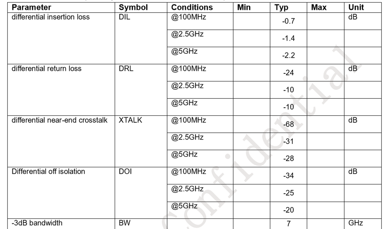

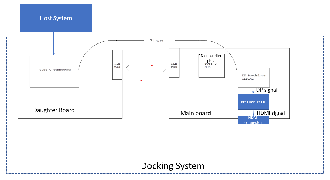

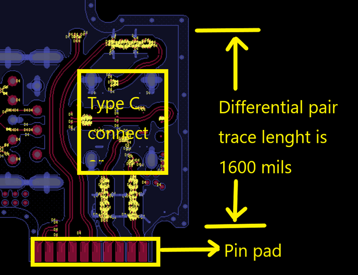

This is a type-c docking system with block diagram as below.  THe daughter board and main board would be connected through a 10-pin pad as shown in the bottom, but the signal loss of this pad is unknown.  What we know now is the trace length is totally around 3 inch from type-c connector to TDP142.  I think we also need to consider the loss of type-c mux (signal loss table as below) within the PD controller.  Do you see any concern for such application?  What is the signal loss acceptable from pin pad ?  WIll it be better to use SN65DP141?
The layout of the pin pad would look like below.

    Why not use the TUSB1064 or TUSB564 for this application? The TUSB564 or the 1064 combines the function of the Type-C MUX and the DP142.

    As described in the block diagram, they've chosen a PD controller embedded with type-c MUX function (non-TI solution) since the total cost is better.  Do you think we can support this scenario if they choose a stand alone PD controller plus TUSB1064?

    Sorry I missed the part which the PD controller already includes the Type-C MUX. In this case, you can use the DP142 in this design. Or like you said, a standalone PD controller plus the TUSB1064 will also work.

    The total trace length is 3in which is not a significant amount of loss. The key is the loss of the two pin pads and the Type-C MUX, and whether the total loss is within the TDP142 EQ compensation range.

    Thanks for your reply.  Based on the 3-inch trace length and the type-c mux listed below (need to support 8.1Gbps), what is the maximum of loss (dB) can be tolerated from the pin pad?

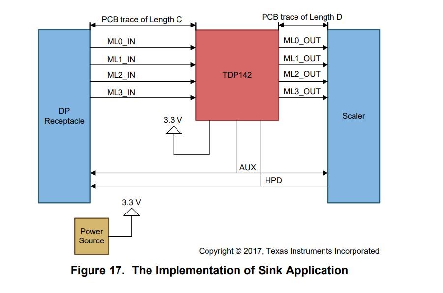

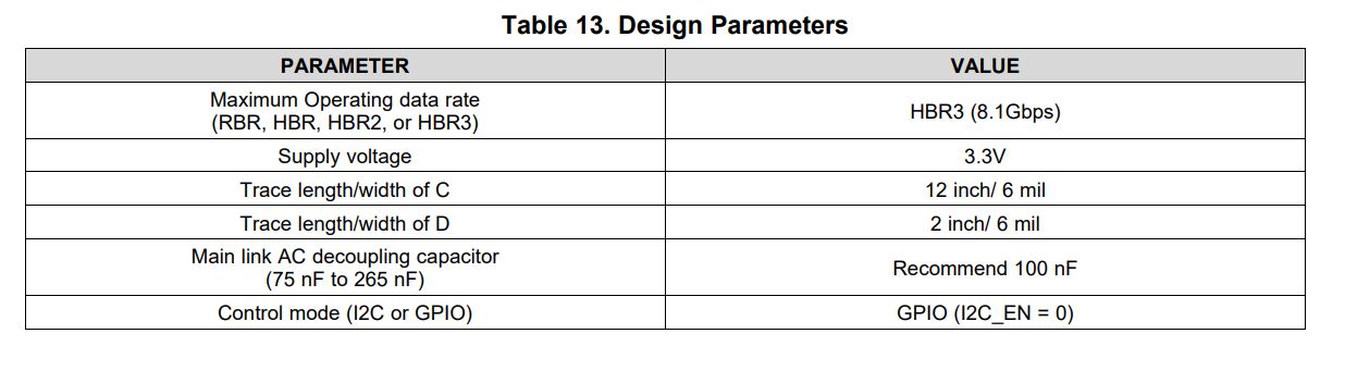

    Please refer to Figure 17 and Table 13 in the TDP142 datasheet. Between the receptacle and the TDP142 which is PCB trace of length C, we recommended a 12in trace. The 3in insertion loss plus ~2.2dB MUX loss are within the TDP142 RX compensation range.

    Does it mean the trace length from TDP142 to "DP to HDMI Bridge" should be less than 2-inch? -> Correct
    The TDP142 is a linear redriver, it only has a RX equalizer, and does not have TX Swing or Pre-emphasis control. With a linear redriver, you want to place the TDP142 as far away from the source as possible (The distance between the Type-C connector and the TDP142) to maximize its RX equalizer capability as much as possible.
    The 2-in is not a hard requirement. But more a recommendation to give the Source TX and Sink (DP to HDMI) RX as much margin as possible. You can go longer than 2-in, but that's taking margin away from the Source TX and Sink RX.
