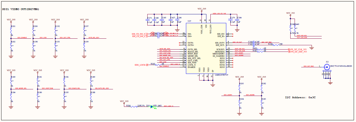

We are using LMH1297 for 12G SDI OUT application using Zynq US+ MPSoC. When we use 12G SDI to HDMI Converter from BMD ( Teranex Mini SDI - HDMI 12G) to monitor the output, lock is happening in module for 4K 30fps and  we are able to see the output in monitor as well. But for 4K@60fps BMD module itself is not locking. Then we tried connecting 12G SDI output with Teranex Standard converter AV, We are able to observe output at 4K 60fps but with lot of glitches. I have attached the schematics section, could you please review the same and help us to find the issue. Reference clock given is 148.5MHz single clock to GTH bank.

    I could vaguely see your schematic. It seems you are using the device in cable driver mode. In this mode, SDI_OUT 75-ohm driver is used.
    SDI_IO in your setup is acting like a cable driver as well(in pin mode and cable driver mode we cannot turn off this output). However, this output is not terminated. Also, i believe you are enabling OUT0 100-ohm output through OUT0_SEL as well and this output is not terminated.
    In your application, i was expecting that you would use SDI_IO as cable driver and use SDI_OUT_SEL to disable the 2nd cable driver by floating this pin. Also, we should float OUT0_SEL to disable 100-ohm output. With these outputs un-terminated and active there is high reflections. It would be good if we can take care of these to see if this takes care of the issue you  are seeing. Also, please send me a pdf copy of your schematic so it would be more readable. We regularly use 59.94 or 60Hz frame and have not experienced this issue.

  • Hi Vishnav,
    1). Yes for sure through the I2C you can control these and turn off or power down both OUT0 and SDI_IO driver.
    2). One th9ing you can try, OUT0_SEL is pin 4. Maybe you can run an experiment and use a blue wire to pull this pin high. This may improve things.

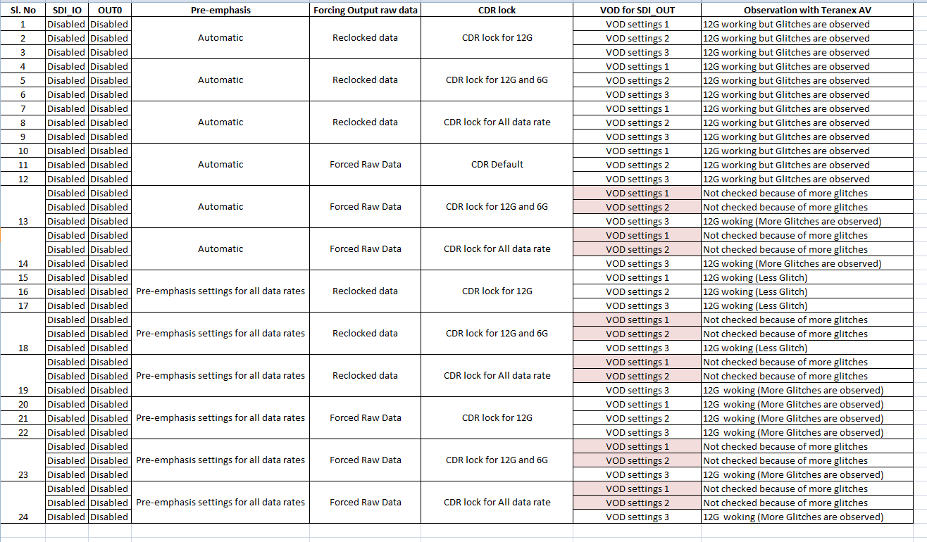

  • Hi Nasser,
    Please go through the test observation we obtained till now. In all the cases we are getting glitches for 12G SDI output. In some cases it seems to be more.
    For test case 15,16,17 and 18 we got less glitches. Also suggest any method to solve this issue.
    Vyshnav Krishnan
