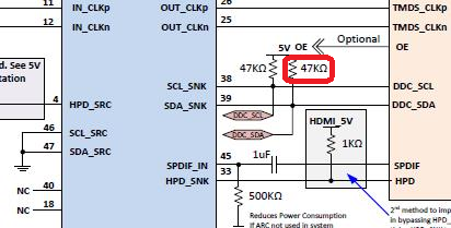

My customer have an question about SDA_SINK pullup.
They believe, the SDA_SINK pullup resister is not needed from HDMI standard. (SCL_SNK is needed it)
However, the datasheet reference schematics has pullup resister for SDA_SINK.
Is it must needed?
Also, it is no problem that HPD and DDC pullup voltage(5V) supply from HDMI_IN connector? (just confirm)
I seems, EVM's HPD and DDC pullup voltage is supplied from HDMI_IN

    It is correct that the HDMI spec only specifies the 47k pullup on the SCL_SNK for the sink side design. I don't know why the spec only defined the pullup on SCL_SNK, but not the SDA_SNK. But I would have pull-up on both the SDA_SNK and the SCL_SNK and you can always de-populate the pullup on the SDA_SNK.
    You can connect the HPD to the 5V power signal through a 1k resistor. But the source needs to pull down the HPD signal in order to reliably differentiate between a disconnected and connected HPD.

    In the HDMI standard, there is a pull-up on the Source side, so I think that it is a rule that the pull-up of SDA_SINK is unnecessary.
    It does not mean that SDA_SINK needs a pull-up resistor peculiar to TMDS181.
    Is HDMI_5V input from SINK good for 5V used here?
    Or is it 5V generated in the board?
    Regarding the problem of notation, HPD was "HDMI_5V" and DDC was "5V", so I thought it was a different 5V.
    Both 5V of EVM were "board_5V".
    Yamashita

    5V is not provided by the sink. The 5V is always provide by the source.
    The TMDS181RGZEVMs have been configured to receive 5 V from the HDMI source connection to drive the Board_5V. This has been done by removing U6 and installing R104 on the EVMs. So both the DDC_SNK and HPD_SNK are connected to the Board_5V.
    David

    Could you please tell me if SDA_SINK needs a pull-up resistor unique to TMDS181?
    Is there any problem without attaching a pull-up resistor to SDA_SINK as determined by the HDMI standard?
    Yamashita
  • Yamashita-san
    The TMDS181 datasheet was written assuming the HDMI spec required 47k pullup on SDA_SNK and SCL_SNK. So the 47k requirement is not unique to the TMDS181, more a wrong assumption being made.
    But with the stronger 2k pullup on the source side, even with the 47k populated on the SDA_SNK, the total resistance is still closer to the 2k resistor.
    I would still leave the option of having 47k pullup on the SDA_SNK but choose not to populate it.
