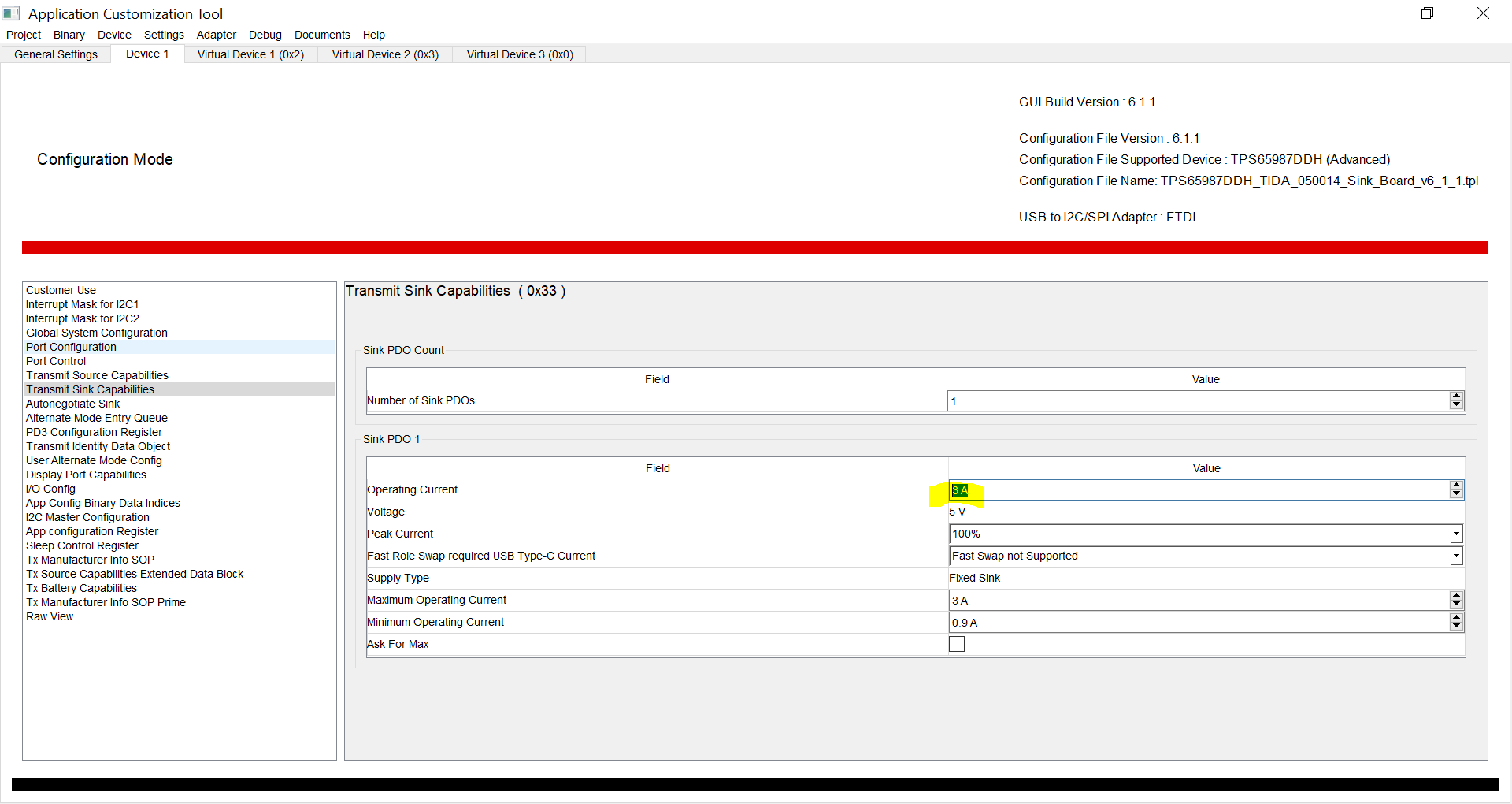

  • Dear Hide,
    It looks like you need to modify the Source Board. Please modify the operating current as shown below when programming the sink board using the default TPS65987DDH Sink Board project.
    I tested 5 V at sink with 3 A.
    Mike Emanuel
    I understand that I have to modify the sink capability (5V/0.9A => 5V/3A).
    Is my understanding correct?
    Sink:S200 and start up timing        5V/0.9A => 5V/3A (modify)
    S201                                        5V/3A, 9V/3A
    S202                                        5V/3A, 9V/3A, 15V/3A
    S203                                        5V/3A, 9V/3A, 15V/3A,20V/3A
    Hide
  • Dear Hide,
    Q1: The source board will provide the highest power capability for each voltage that both the sink and the source share. So if the source is 5 V/3 A and the sink is 5 V/0.9 A, only 0.9 A will be provided.
    Q2: Changing the sink capability will allow for 3 A current.
    Q3: Make the following change to realize this change.
    Mike Emanuel

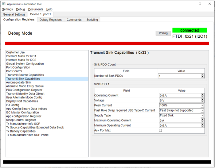

  • Hi Mike-san,
    Sorry for contacting you repeatedly.
    We are evaluating TPS65987 at the following conditions.
    I understand that if source capability is 5V/3A and sink capability is 5V/0.9A, source board supply 5V/0.9A.
    However, our evaluation result, source board can supply 5V/1.6A (more than 0.9A).
    Is this the correct behavior?
    <Case1>
    TPS65987EVM(Source)* => USB-C-PD-DUO-EVM Sink Board* => Dummy Load (Around 1.6A)
    *EVMs are default setting.
    <Sink capability>
    Hide
  • Dear Hide,
    Your operating current range is from 0.9 A to 3.0 A so it can support 1.6 A. The selected operating current is indeed 0.9 A, but your maximum is up to 3.0 A.
