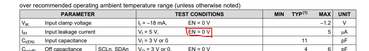

Part Number: PCA9306
If the device is unpowered, what leakage current will there be on the SCL/SDA lines?

Thank you Clemens/Danny. I saw that in the datasheet but wasn't sure if I was interpreting it correctly. I appreciate the clarification.

Hi Clemens,
I actually have a follow up question about the floating supplies here.
If the supplies are floating, what is the DC impedance of the SCL/SDA pins?

In the worst case, "floating" is the same as "fully powered". (But the current through the 200 kΩ resistor will slowly discharge the supply.)
