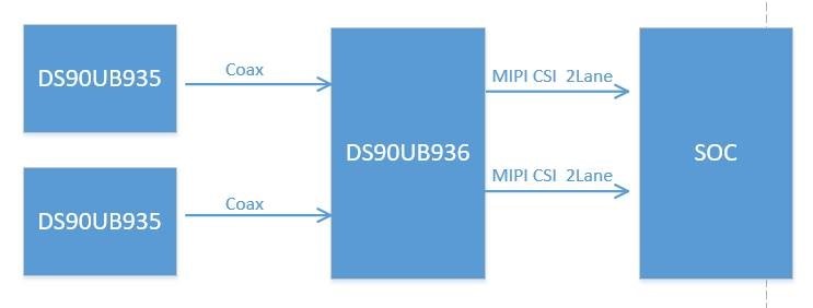

May I ask whether the following solution is ok, which means that 936 link to two separate sers?
Customer SOC don't support virtual channel?

do you mean, you want each Camera to be on seperate 2-lanes output? If this is the case, this will not work.
You need to use the 960 instead of the 936, to have to seperate outputs.
