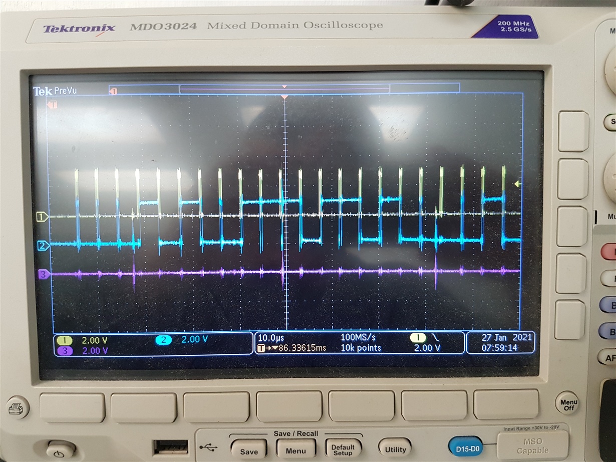

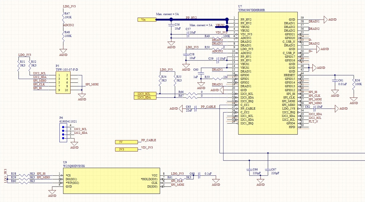

    Besides, I have double checked the hardware external flash configuration and VIN_3V3. There is VIN_3V3 to supply the TPS65987D and it can outputs the LDO_3V3 to supply the external flash W25Q80DVSNIG. Please see my schematics in the attachment for the reference. After powering the TPS65987D, there are some communication signals, which are shown on another jpg attachment (In that jpg, the CRO yellow line is SPI_CLK. Blue line is SPI_MISO. Red line is SPI_SS), over the SPI pins. Also, each time I update the external flash, I power down and then power up the PCBA to let the PD controller have power cycle to load the new patch from the external flash.

  • Hi Alan,
    I will review the schematic and provide feedback by Friday. I would also recommend double checking ADCIN pins to make sure they are configured properly to have the PD controller program the configurations from Flash.

  • Hi Alan,
    The schematic looks fine to me, I think it may be a programming issue. How are you flashing your board? If you have a new Flash IC on your board, you will have to make sure that you are programming the full flash image binary to it, however if you are only using the GUI, it may only be flashing the low region binary. If the Flash IC is new, it won't have the any region pointers in there that are needed for the PD controller to pull the configurations from which could be the reason you are not seeing the right functionality.

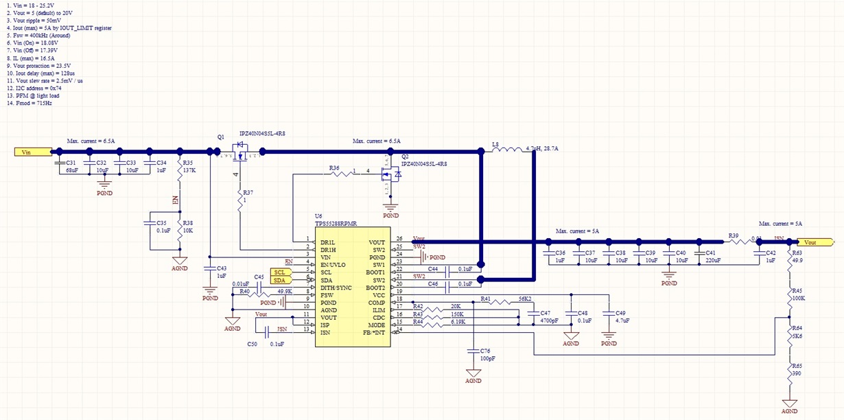

    The VIN comes from TPS55288 and it is supposed to provide the voltage 5V, 9V, 15V, 20V to TPS65987D which is shown in my project file inside the attachment below. Also the schematic related to TPS55288 is displayed below.

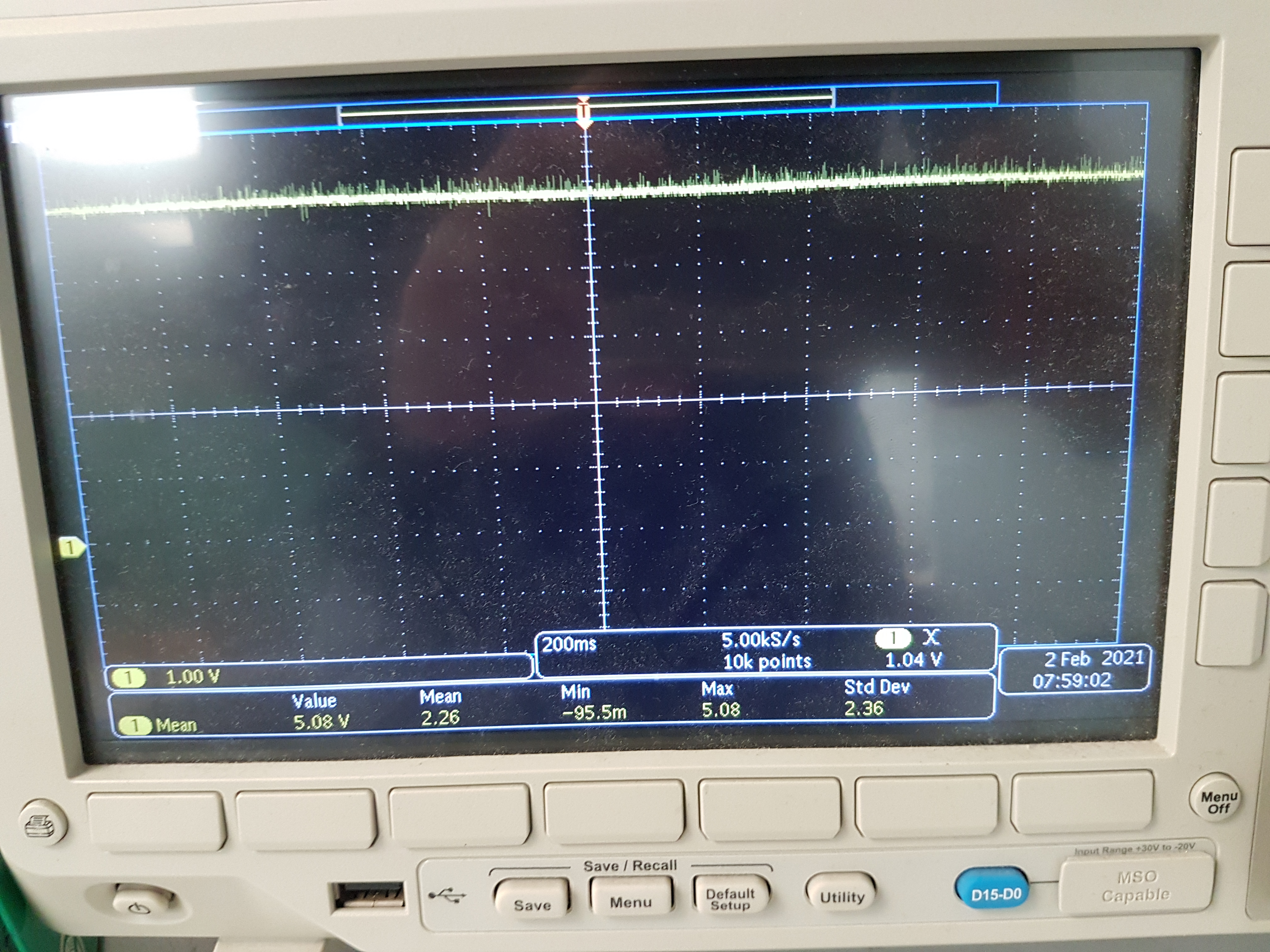

    The Vout connects to the VIN of TPS65987D. The I2C3 of TPS65987D controls TPS55288. In addition, The VBUS waveform is shown below after plugging the PD loading device. There is some noise over the VBUS.
    The waveform of VIN_3V3 is 3.3V (Nothing special).
    CC1 is around 1.6V and CC2 is around 0.4V respectively.

  • Sorry, I made a mistake on posting the TPS55288 schematics on the above reply. Please check it here.

  • Dear Hari,
    After testing with TPS65987D EVM, I think that the root cause of my issue has been found and now my hardware can communicate to the PD loading with changing the output VBUS from 5V to 20V. The root cause is that the VBUS1 pin must connect to the VBUS2 pin although I don't use VBUS1 for sink power. After I short the VBUS1 pin to VBUS2 pin, everything works fine.
