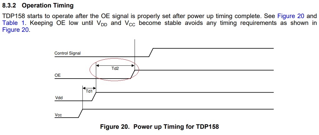

Part Number: TDP158
Hi Sir,
may we know the recommend value of Td2 for power up requence?
There is a typo in Table 1, second row in Table 1 should be Td2, not Td1. So VDD and VCC stable before OE de-assertion is min of 100us.
David
