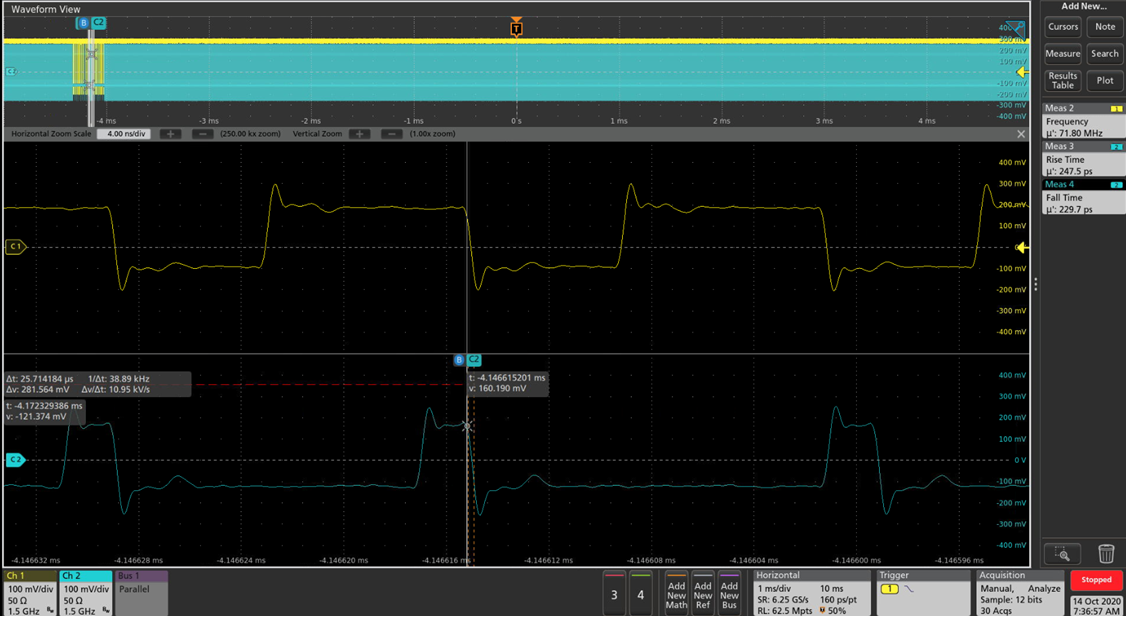

  • Hello Casey,
    Regarding the pixel measurement of LVDS signals, below a screen capture.
    I measure the number of rise time transition on the clock during the HSYNC. I check that the data corresponds to the HSYNC.
    Regarding blanking it is easier since there is no data.
    The measurement are done on the channel 2 of the LVDS and the clock channel
    The DSI LP/HS transition is done at every frame, not every horizontal line. We can observe the transition with the oscilloscope.
    I can also observe the blanking on MIPI lane, but i didn't measure it and its stability.

  • Hey Alex,
    Ok, I'm still confused on how you are taking that measurement and differentiating between HSYNC/VSYNC/DE... I don't see how you are doing that from the scope shot but in any case, here's another question for you.
    See you mentioned that in PCLK from DSI clock mode the display is not flickering, but you also said when you do PATGEN with external timing 0x65 = 0x08, that the video flickers. This should not be the case if the DSI timing is correct. What are you setting for BRIDGE_CLK_MODE when you do this test? Does it change if you set 00 vs 01?
    Only other thing I can think is that the REFCLK frequency you are applying is off in frequency from the average video PCLK from the source. In PCLK from DSI clock mode you are saying it is working correctly. Can you measure the exact PCLK frequency on the 948 side when you are in this mode? Is that frequency equal to what you are applying to the REFCLK pin when you go to external REFCLK mode?
    Casey
  • Hello Casey,
    If you look at the screen below, we see the transition from vertical to horizontal transition. Without a dedicated equipment, manual reading is the only option. Like I2C or UART in the old days.
