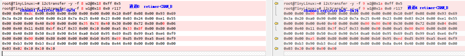

    some new date coming from latest test:
    For now, we have two 10GE XFI under testing:
    Port A could normally work with Loopback , and when set 0x07, could also link-up normally;
    Port B could not link-up when set 0x07;
    if we check the register, we could find that:
    Port_B retimer: reg_0x54==0x80  signal detect
                             reg_0x2==0x0  CDR Not Lock
    Port_A retimer:reg_0x54==0x80  signal detect
                             reg_0x2 bit [5:3]==0x011  CDR Lock
    also some tests result below:
    1. Port_b CPU-MAC PCS Loopback could work normally;
    2.Port_b Tx Fly line to RX could link-up normally;
    3.Dump and compare the two retimer log, it seems have the same register value
    The attached picture is the all channel register dump of the corresponding input ports of the two retimers. The marked channel 0 is the normal channel, and the channel 4 corresponds to the abnormal channel. See if you can get more useful information.
    BR
    Brandon.

  • Hi Brandon,
    Looking over the registers of your bad channel, we can see that register 0x52=0xA5. This register contains the CTLE boost value and is very high.  I have two debug options.  Please try option #1 first and if it does not work, then try option #2.
    1) Manually force CTLE = 0x00
    Please make the following register writes to the bad channel.  The goal of this step is to reduce any over equalization that is occurring.
    Step Register Address Register Value Write Mask Description
    1 0x0A 0x0C 0x0C Assert CDR Reset
    2 0x2D 0x08 0x08 Override CTLE Setting
    3 0x03 0x00 0xFF Set CTLE to 0x00
    4 0x0A 0x00 0x0C Release CDR Reset
    2) Enable DWDM Mode
    This is another step that can be taken to reduce CTLE EQ boost.  This step is only recommended if option #1 fails.
    2 0x13  0x02 0x02 Enable DWDM Mode
    3 0x0A 0x00 0x0C Release CDR Reset
    Please note that in both of the procedures above, you will need to select the appropriate channel register prior to making these writes.
