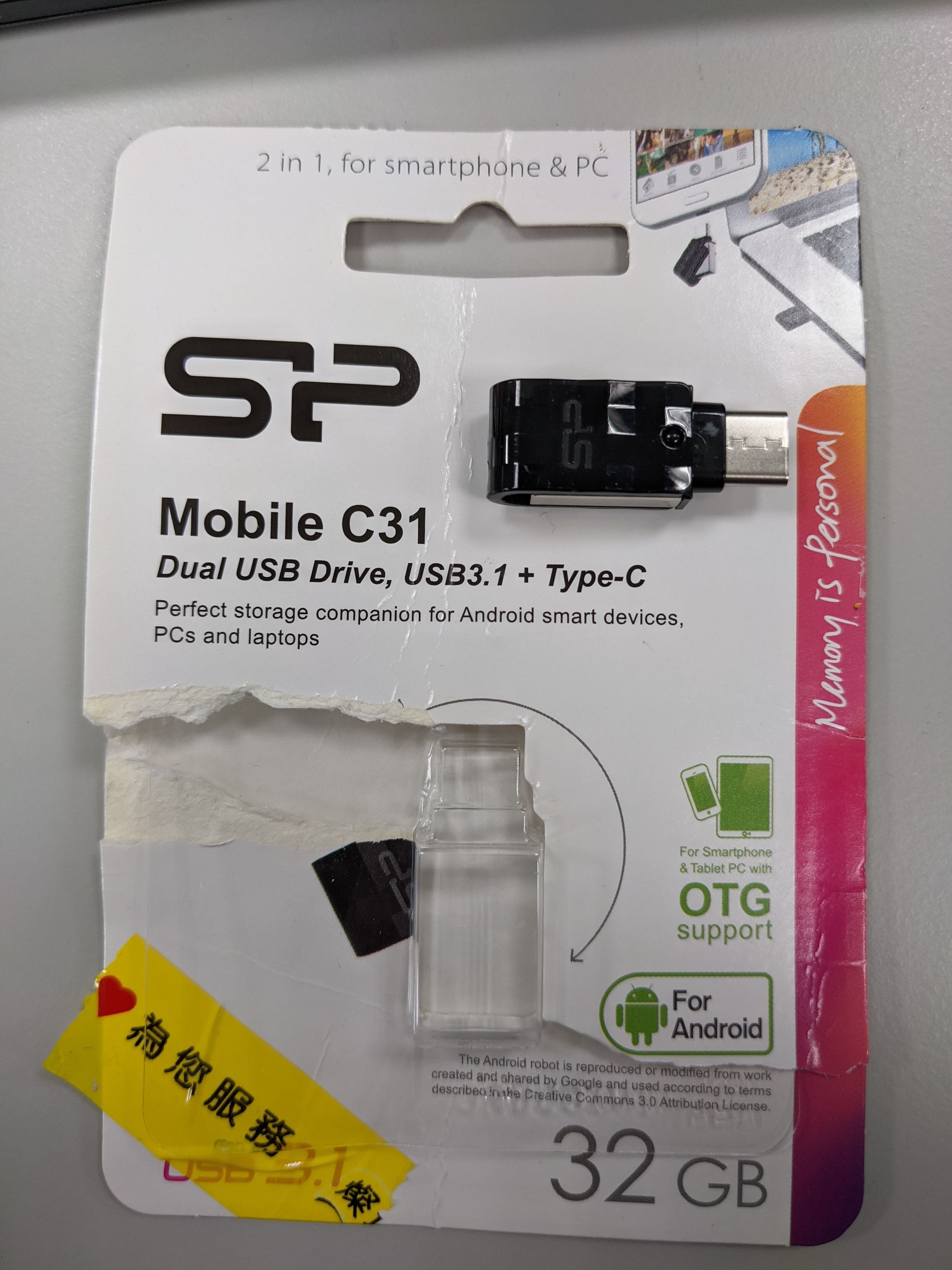

Now Android Auto can be used,
But using Type-C USB 3.1 OTG dual-use flash drives,
type-c is still not available through TPS25830-Q1,
But it can be used by connecting the other end type-A to the car stereo.
Does TPS25830-Q1 support TYPE-C flash drives?
The TPS25830-Q1 support flash drives. I am afraid your DP/M trace is not good.
