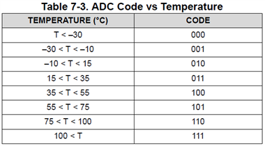

Hi Hamzeh,
Would you pls advise which register can read real time temperature?
We checked Table 32 – 38 not yet get answers.
Thanks, Ian.
Hello Ian,
The raw ADC reading from this table is loaded into the remote deserializer register SENSOR_STS_2. See the DS90UB954-Q1 datasheet for example in register 0x53
