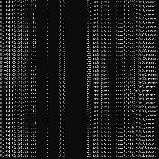

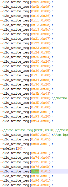

Occasionally, the  display screen abnormal phenomenon,what may be the cause?
One of the phenomena is that the value that registers read is different from the value that registers write.The missing register is 0A 5C 77 78,Thanks!
The application is the same as in the datasheet
    I can't tell from the screen capture, what value are you writing to 0x0A, 0x5C, 0x77, and 0x78? And what values are you reading back from these registers? Are the read back value consistent each time?
    David
  • Hi
    sorry,My question is that there is an abnormality on the display screen,what may be the cause?
    The register values to be written are below,The wrong value to read ,is  5C 77 78,
    The register reads the wrong value. What causes it? Is it related to the abnormal   display screen?
    thanks!

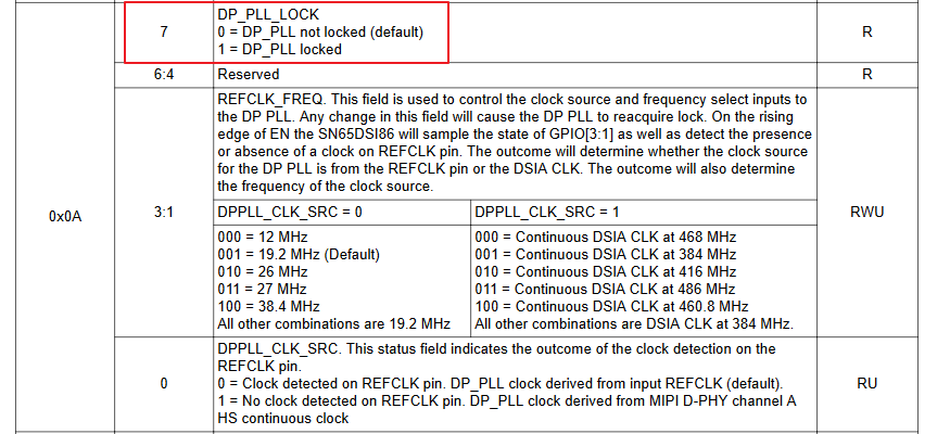

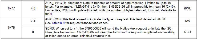

    Register 0x0A bit 7 is the PLL lock indicator and would set to a '1' if the PLL is locked. But register 0x5C, 0x77, 0x78 should not change on its own.

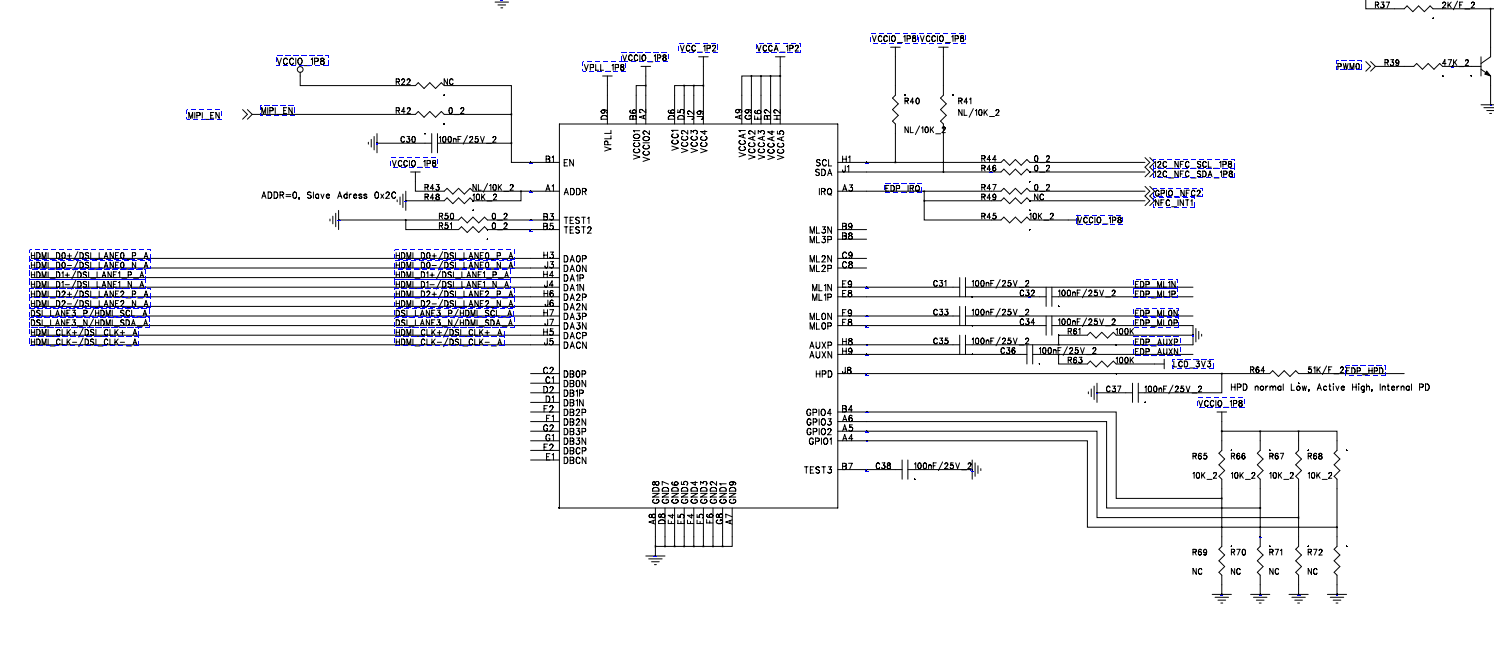

    Can I also take a look at your schematic?

    SCH is below.

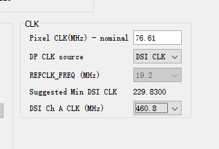

    SN65DSI86 is configured to use the CLK of channel A,
    When the display screen is normally displayed, the measured CLK is about 460m, and when abnormal occurs, the measured frequency is about 920m.
    What could possibly cause it?
    Thanks!
    Can you please measure the clock frequency between the normal and abnormal case? The clock is generated by the MIPI source, are you seeing the clock frequency actually changes?
    David
  • Hi David
     Clock ,normally is 460m, abnormal  is about 920m,thanks!
    The DSI clock is generated by the DSI source, so you have to look and see why the DSI source is changing its clock frequency.
    David
