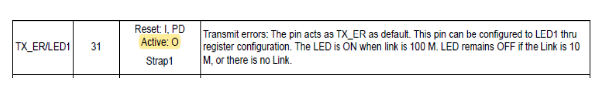

DP83826I: Pin settings for TX_ER
Part Number: DP83826I
Hi Team,
My customer would like to use the TX_ER option when Basic mode is selected in MII.
This pin is used for both LED1 and TX_ER.
When BASIC mode is selected, it is "TX_ER as default".
TX_ER must be an input pin because it needs to accept signals from the outside.
It is described as "Active:O" in the datasheet.Is the datasheet wrong?
I think "Active:I" when TX_ER is selected.
So I think I/O is the correct notation, since there are both cases.
