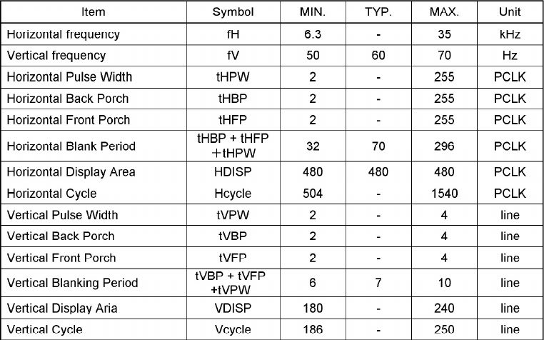

Our customer's application is as below:
SOC <--DSI--> ds90ub941 serializer <--FPDLINK--> ds90ub948 deserializer <--oLDI--> ds90cf366 <--RGB--> display monitor (480x240)
ds90ub941 configured CLOCK Mode 0: “FPD-Link III is generated from DSI clock. The DSI clock has to be continuous.”。
First he configured the  4 DSI data lane(by MODE_SEL0 configuration), but the display monitor couldn't appear。
And then he configured the register 0X4F and changed to 1 lane, the display could appear.
So the question is that:
1. The datasheet described the pixel clock frequency range is 25Mhz to 105 MHz over one lane. But why the 480*240 LCD could dispaly?
2.Why the data lane is changed from 4 to 1, and the LCD could display?
Best regards
Kailyn

  • Hi Michael,
    Thank  you for your reply. Below is the part of the LCD datasheet, and we could calculate the total pixel clock:
       (480+296)*(240+10)*60=11640000=11.64.MHz
    If it could work normally under this resolution, does it have any potential question during long work?
    Very appreciated
    Best regards
    Kailyn
  • Hi Kailyn,
    What is the Horizontal Cycle?
    The 25 MHz to 105 MHz PCLK is the rates between which we validate  the 941AS to work with. I do not know why your application works with the 941AS and 948 but we cannot guarantee that this system will work in all temps and all cases, so I advise not using the 941AS for this display unless you can increase the PCLK.
    The DSI has a requirement of at least 150Mbps per lane, with 4 lanes your data per lane was below 150 Mbps per lane and with 1 lane you are over this 150 Mbps per lane requirement.
    Michael W.
  • Hello Michael,
    The horizontal cycle is 504~1540 PCLK. Customer used 941 because its input is compatible with MIPI DSI input.  And we have two serializers UB941and UH941 which minimum pixel clock are both 25Mhz .
    Best regards
    Kailyn
  • Yes, but what is horizontal cycle? If the H active is 480 and the H blanking is 296 max and the max framerate is 70 Hz then the number of H pixels per sec is 54320. I dont see what horizontal cycle is.
