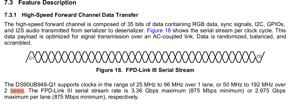

    There are two things which are making me nervous. (1) number of lanes -- my system is using 2 (2) pixel clock -- Jacinto7 DSS/DSI is having ~75MHz. Could you think of issues due to these?

    1: How many DSI lanes are you using? from your MODE_SEL setting is seems to be 4 DSI lanes but for port 1 you have it set to 2 lanes.
    2: your PCLK should be about 166MHz for the full superframe image. Why would the PCLK in the Jacinto be 75 MHz?

    1) Panel remains blank if I will force UB941 to 4 lanes via BRIDGE_CTL so that's why it is set to 2 lanes.
    There is UB948 down the line and as per its data sheet is is 2 lanes.
    2) PCLK: There seems to be problem in changing PCLK from DSI and there are a couple of tickets related to it:
    Do you think the issue I am facing is because of PCLK and lanes?

    1) the BRIDGE_CTL register sets the number of DSI lanes not the number of FPD_lanes. Most systems use 4 DSI lanes. also the TX_PORT_SEL(0x1E) register selects which FPD-Link and DSI port you are writing to and reading from.
    2) The input PCLK should not be changing for the 941AS you should follow the "Power-Up and Initialization" section of the datasheet.
    Michael W.
  • Hi Micheal,
    1) Bear with me. Are you saying that the lanes which are referred in the picture of UB948 datasheet are the FPD_lanes not the DSI?
    Yes I do agree with you that BRIDGE_CTL is used to configure DSI lanes and this is what I am doing. I am seeing that panel only show contents if it is set 2 lanes.
    2) I was reviewing 10.2 Power-Up and Initialization of snls640c.pdf to match my script and realized that document is asking for Register 0x40 = 0x10 which does not make sense as it is trying to manipulate reserved bits.
    I was thinking of the output I am seeing that made some observation: (1) The lines I am seeing as garbage are very pretty much consistent and they always appear as they are. (2) These lines seems to be generated from somewhere else as I have seen the same pattern after filling framebuffer with completely a different color.  It looks very odd that panel is having some part of correct contents but suddenly it will jump to these random lines.
    Thanks for the help.
  • Hi Max,
    1) The lanes the 948 datasheet is referring to is the FPD-Link Lanes, but the BRIDGE_CTL register on the 941 controls the number of  DSI lanes.
    2) This script is required at device startup like the diagrams show. the Register 0x40 = 0x10 is correct.
    Can you provide your displays timing requirements?
    Michael W.
