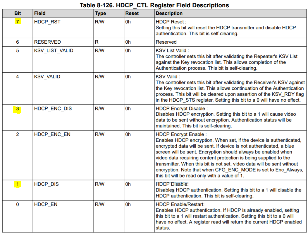

Hello Roy,
As I said earlier, the Hardware is same. So, you can pair them together. But you need to make sure you are not enabling HDCP in the UH941AS device.
Hello Roy,
As you can see, all default values in register 0xC4 and 0xC3 are 0. This means HDCP is not active by default. But if for some reason you have activated it and need to disable it, then yes, you need to set the bits 0xC3[3] and 0xC3[1] = 1.
