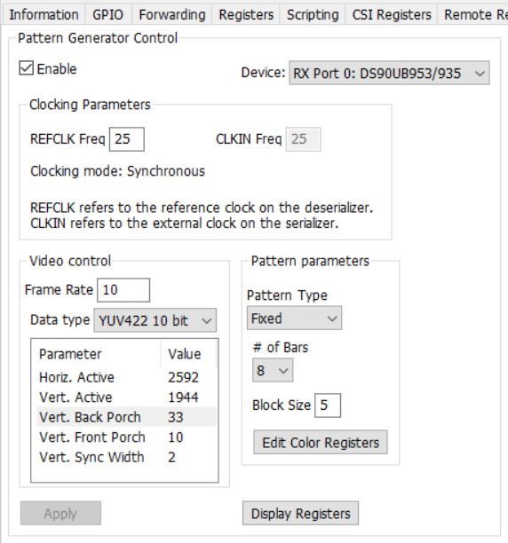

  • Hello Casey,
    Thanks for information.
    May you share the register that you initially check for link and timing parameters?
    954 : 0x04 = 0xDF (PASS/LOCK ok, REFCLK is detected.) I think this is ok.
    954 : 0x35 = 0x00, Is this ok? 0x35[1] = 0 which means Input streams are not synchronized, but we set synchronous mode.
    954 : 0x22 = 0x00, Not synchronous.
    954 : 0x4D = 0x13, ok
    954 : 0x51-0x54, is our data ok?
    Reg = 0,0x0051,0x00
    Reg = 0,0x0052,0x00
    Reg = 0,0x0053,0x03
    Reg = 0,0x0054,0x06
    0x4E and 0x7A is showing that checksum is error, may you let me know the possible reason? REFCLK is not stable?
    What is the CSI-2 lane rate on the 953 side? Also what is the REFCLK value attached to the 954? I will check with customer.
    Roy
  • Hello Roy,
    954 register 0x54 seems to indicate that the CSI-2 errors are originating on the 953 side so please do check the 953 side CSI-2 lane rate and the 954 REFCLK value. All the other registers look ok as you say
    Casey
  • Hi Casey,
    The lane rate is about 750MHz and REFCLK = 24MHz. Our image sensor is OV(OS05A20).
    Do you have any idea?
    Roy
  • Hi Roy,
    Looks like the sensor that you are using is 5M pixel image sensor. Do you know what is the resolution, frame rate, and data ID that your customer is using? It is probably that they are exceeding FPD3 bandwidth. The maximum bandwidth for 953-954 FPD is 3.84Gbps with a 24MHz ref clock.
    Aaron
  • Hi Aaron,
    We only use 1080p and frame rate is 30. But our  0x73 ~ 0x76 register couldnt detect the correct information.
    DO you have any idea?
    Roy
  • Hello Roy,
    The max lane rate at the 953 side is related to the REFCLK value at the 954 in synchronous mode. The max CSI-2 lane rate is REFCLK*32 for synchronous mode which means in this configuration the max lane rate is 24*32 = 768Mbps which would be a MIPI CSI-2 clock of 384MHz.
    The provided CSI-2 source at 750MHz = 1500Mbps will not work in this configuration as the link will not have enough bandwidth.
    Casey
  • Hello Casey,
    Thank you for your information. I will let customer to lower down the lane speed, but it would spend a little time.
    But we would like to use 953 internal pattern generation first to see whether display could show pattern normally or not. Please see below setup and result.
    Could you let me know if the pattern is abnormal, what is the most possible root cause? data type or parameter?
    Roy
  • Hello Roy,
    The ALP tab looks like it is set up correctly and this pattern should be low enough BW to work with the link. Is the customer hitting the "apply" button to make sure that the pattern registers are being programmed into the 953? The image you sent shows the incorrect resolution: 1031x577 instead of 2592x1944. The reason that it looks like there is a mix of many colors per bar is due to the color registers setup. I would recommend using the same byte value for PGEN_COLOR0 - PGEN_COLOR4 since the block size is 5 bytes for this data pattern
    Casey
