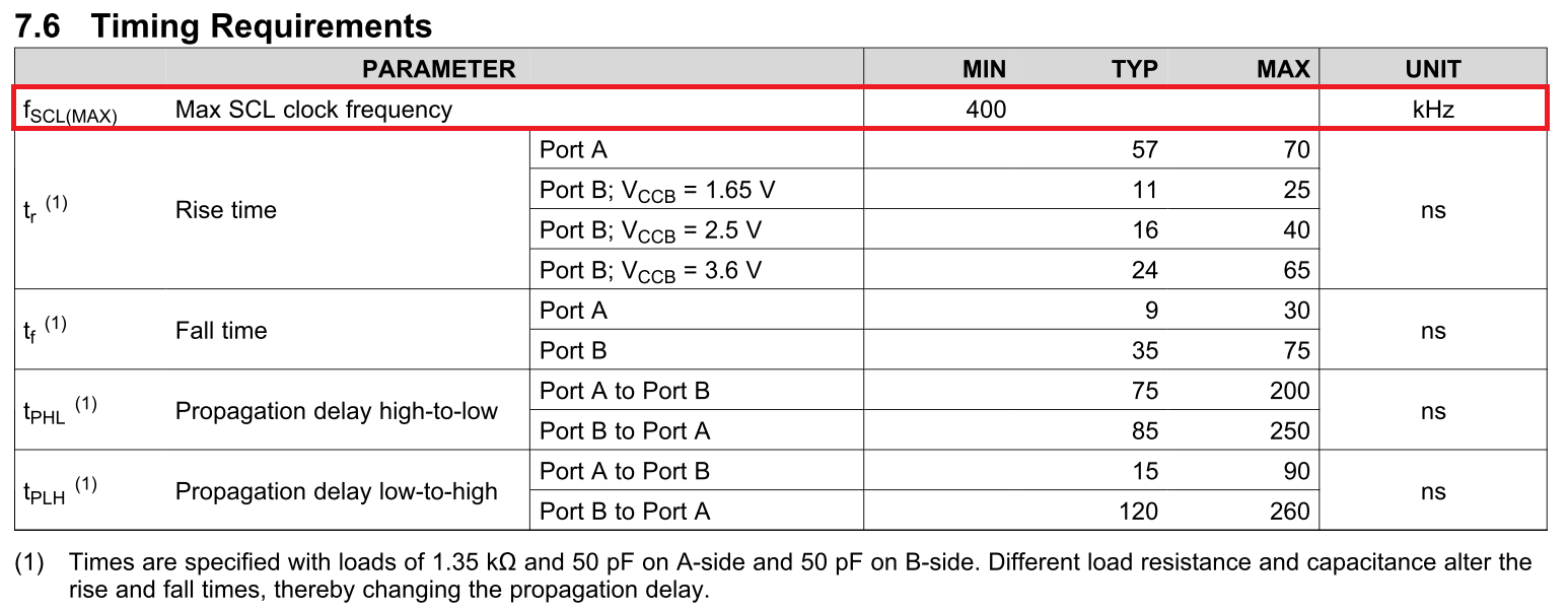

I found that "Max SCL clock frequency" is only mentioned on page 6 of TCA9803 data sheet as follows. However, I cannot find "Min SCL clock frequency".
So, could you please tell me the minimum value?
