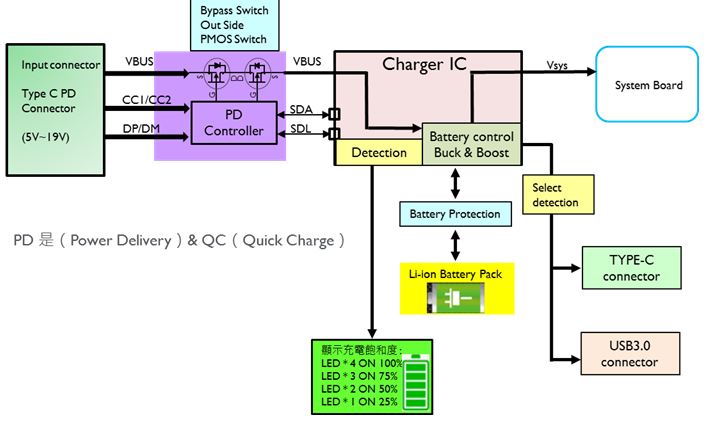

Hi Team,
Do we have total reference design that could meet below requirements?

Hi Roy,
Yes we have TIDA-050047 that uses the TPS25750D along with the BQ25792.
