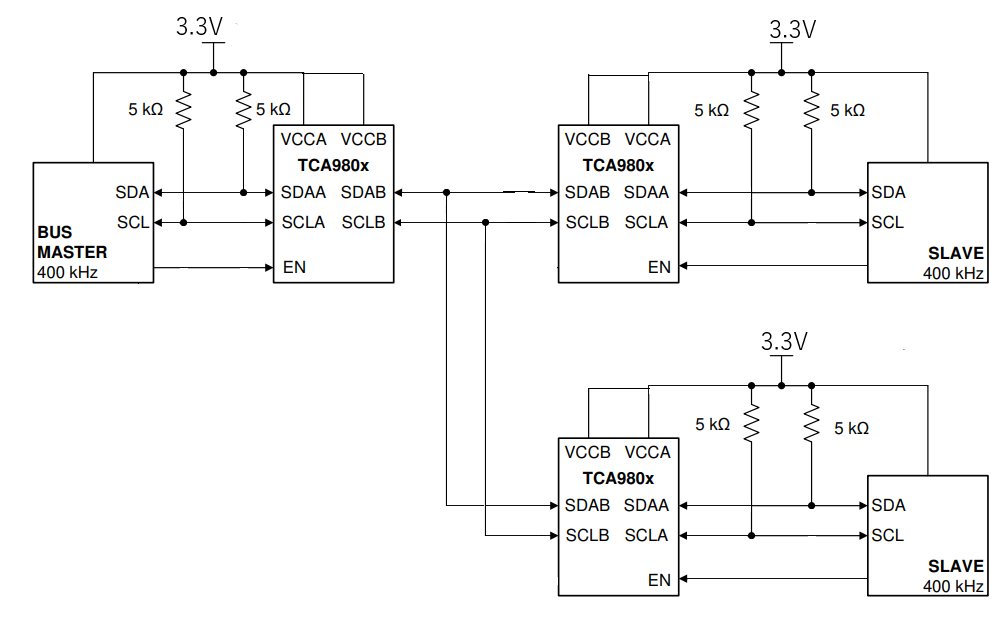

Dear Specialists,
My customer is considering TCA9803 and has a question.
I would be grateful if you could advise.
I am considering TCA9803DGKR.
(1) Connect the A side of TCA9803 to the I2C master device side (in this case, the microcomputer side).
I'm thinking of connecting the B side to the B side of the 9803, which is also mounted on the slave device, and connecting the A side to the slave device side.
(2) Is it okay to connect multiple slaves in the configuration of (1)?
Could you please see the block diagram below.

  • Mutiple TCA980x B sides cannot be connected together; see section 10.1.2.2 of the datasheet.
    Swap A and B on the two right buffers (and remove the pull-ups on the B sides). This is similar to the example in section 10.2.4 of the datasheet, but with multiple A sides (which is allowed).
  • Hi Shinichi,
    Just to echo Clemens (He's correct btw), B sides of TCA9803 cannot connect to each other. Flipping the devices on the right to make B side face the I2C responder devices is the suggested solution unless there is a reason why you can't.
    -Bobby

  • Hi Clemens and Bobby,
    I sent your suggestion to the customer.
    They'd like to confirm the Fugure listed below.
    Is there any probblem.
    I appreciate your great help and cooperation.
    Shinichi
  • Hi Shinichi,
    This looks fine to me.
    If you want a more thorough schematic review offline you can reach me at duynguyen@ti.com
    -Bobby
