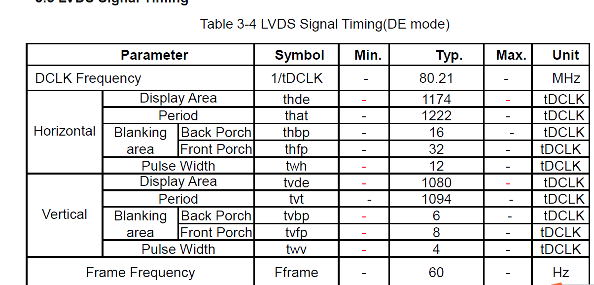

We need use HDMI signal of the PC as the video source, the serializer uses DS90UB949 EVB Kit, the deserializer is DS90UB948, the PC output is the standard HDMI signal, the TFT LCD module  used BOE 13.2 inch product,  maximum resolution supports 2348(H) ×RGB ×1080(V), and the backlight has been lighted, but the screen can not display normally. we can use Analog launch pad to read and write the registers. please kindly tell us how to modify the registers to light the screen.

  • Hi Thomas,
    I would need the detailed timing to do  that. Could you provide all the horizontal and vertical timing parameter including blanking information such as back porch, front porch and sync width?
    Charley Cai
  • Hi Charley Cai
    Thank you for your replying.
    I think the parameter of the TFT module that you need is in the datasheet. You can refer to the attachment.

  • Hi Thomas,
    You can try this EDID
    00FFFFFFFFFFFF00042100000000000001000104A20B0A00000000000000000000000000000001000100010001000100010001000100AA3E2C1290381240401884007A6C0000001800000010000000000000000000000000000000000010000000000000000000000000000000000000000000000000000000000000000000E2

  • Hi Charley Cai
    I ran the script.The screen is responding but still can't display normally.
    I made a video for reference.and I suspect that EDID is not quite right,
    Please help us troubleshoot the problem.
  • Hi Li,
    Please see if you can use an EDID tool to modify the EDID to fit your panel.
    Charley Cai
  • Hi Charley Cai
    Do you have the EDID Tool and the instructions for the use of tools? We have no experience in modifying EDID. We hope you can help us solve this problem.
    Thomas
  • Hi Thomas,
    You can use this tool.
    https://www.deltacast.tv/products/free-software/e-edid-editor
    Charley Cai
