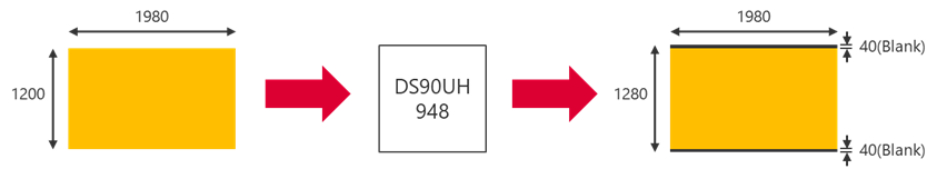

For DS90UH948-Q1, Customer want to insert blank for output picture as below.
Could you please teach me the way how to insert blank?

Hi Yuta,
The blanking needs to be added at the video source as the UH948 cannot alter video data.

Hello Charley,
Thanks for your answer. I understood the UH948 can't.
Is there any other device which can alter the video data?
Yuta Kurimoto
Hi Yuta,
I that case, you will be looking for a video scaler chip
