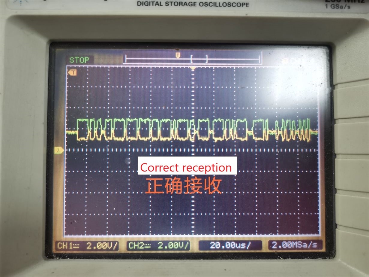

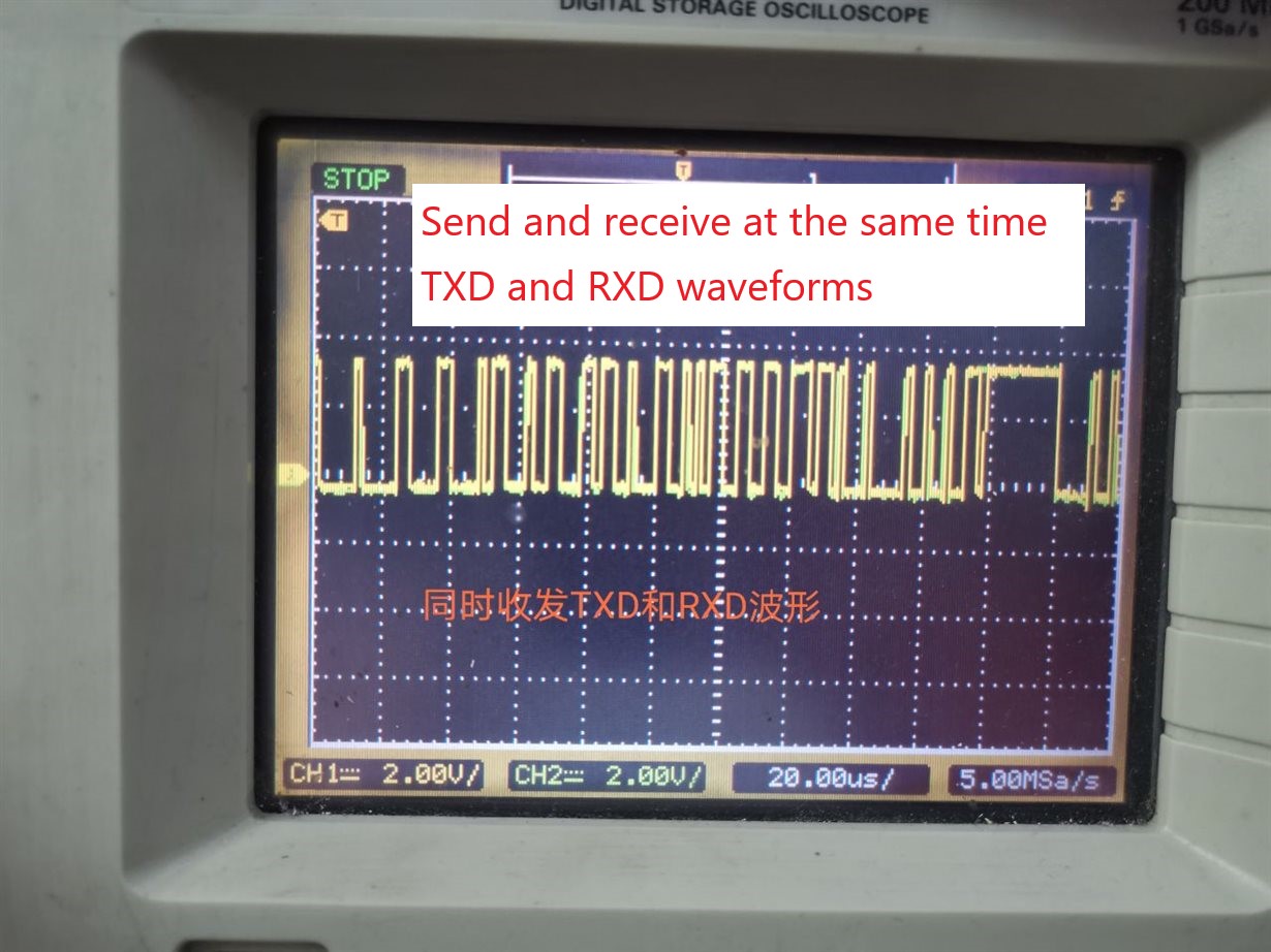

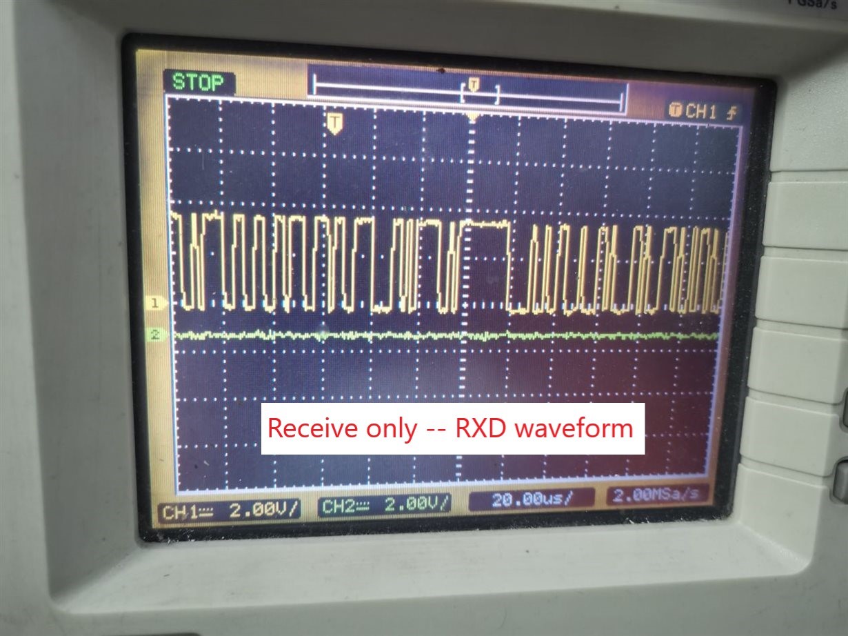

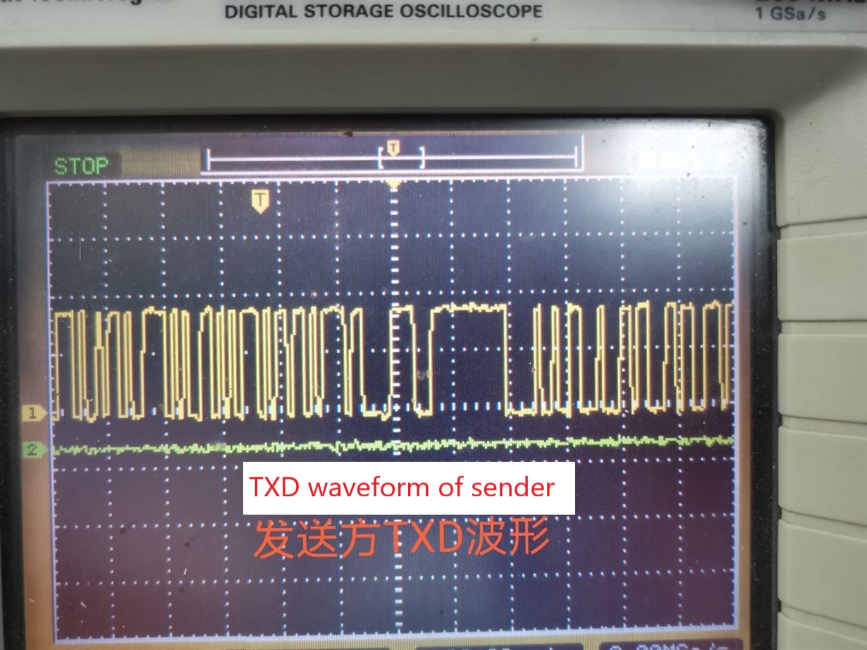

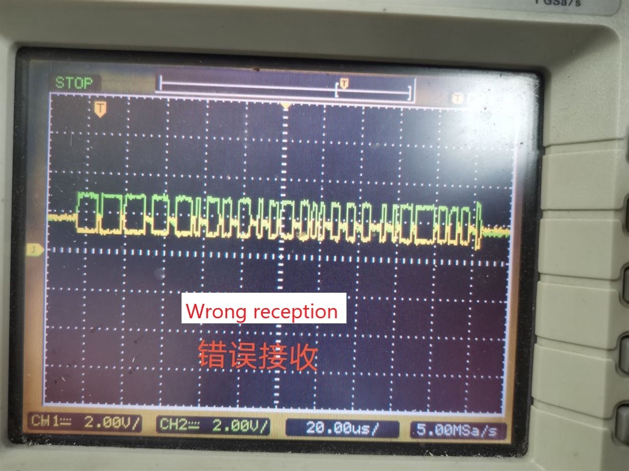

  • Hi Eric,
    Thank you very much for your detailed reply. I learned a lot from it.
    The following pictures are the waveforms measured by the customer. Could you help analyze them. Thank you in advance.
  • Hi Amy,
    All of these waveforms look good to me. The CAN bus shows valid CAN data and the transceiver appears to be able to accurately interpret the state of the bus. I don't suspect that the loss of data is occurring at the transceiver level here.
    I would check to make sure the CAN controllers in this system are configured correctly and are using unique IDs when transmitting their messages. This is important to ensure that every node can distinguish which individual node has won arbitration for a certain frame.
    I would also check the code logic to ensure that every message is being handled and interrupts are recognized, even when the node is configured to send data as well. The way this is implemented can vary greater by system, so I'm afraid I can't give much more specific advice than this.
    If you are having trouble checking these things, I can also recommend some analog debug methods to identify what might be wrong. Capturing the transmit signals of both node A and node B (TXD1, TXD2) and the CAN bus (CANH, CANL) on the same scope can help determine which dominant states (viewed on the CAN bus) are being driven by which node (lows on TXDn will correspond with dominants on the CAN bus). If both TXD lines are exactly the same during arbitration (first several bits) and both continue after this phase (for remainder of the CAN frame), arbitration has failed and both nodes are transmitting at the same time. In the correct case, one TXDn line will stop attempting to transmit after arbitration and will wait for the next frame to attempt to send data again.
