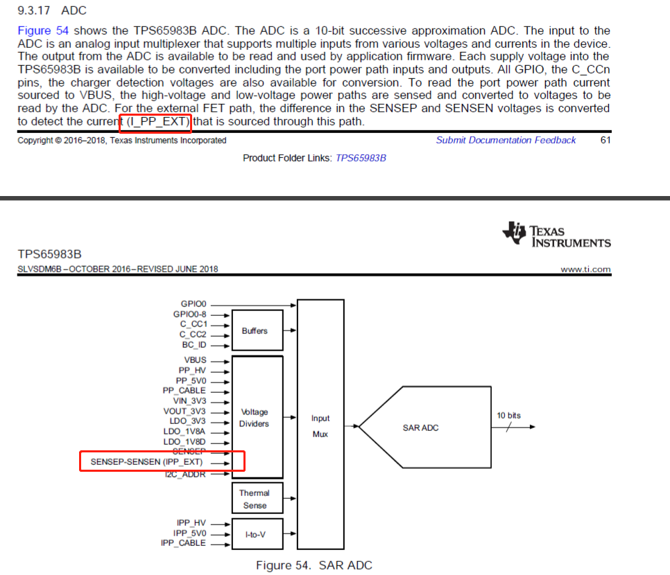

TPS65983 internal integrated ADC, it can detect the current of PP EXT, but there is no detailed information on how to use it.
If I want to read the current of PP EXT through I2C interface:
1. Please provide detailed I2C timing.
2. Which register information needs to be read.
3. How to convert hexadecimal data returned by register into current value.

    Here's a screenshot
    You can read the current through the PP_EXT power path by reading bytes 9-10 of register 0x6A. You can reference the host interface technical reference manual for further details
