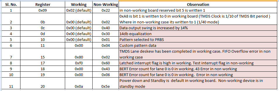

We are using TMDS181 for HDMI Sink application. Initially Pin strapping settings were given and later we have enabled I2C for debugging purpose. Currently in one board, we are able to get the input  properly for 1080p and everything looks fine. In another board we are not getting input. So we checked TMDS clock out from the IC and found that its not coming, but till IC input pin 148.5MHz clock is observed from connector. Even though the hardware configuration remains same behavior of the ICs are different. Later for debugging, we have compared register sets of both working and non-working ICs and found there are differences in few registers. 0x0b register value is 0x00 for working board and 0x02  for non-working board, which means TMDS clock is set for 1/40 of TMDS period in non-working board whereas its 1/10 in working board. To solve this, we tried writing the 0x0b register manually and found that bit 1 of 0x0b register is not getting changed. As per TI data sheet, this register is set by value of 0xA8 register value. Also it should get cleared when HPD_SINK is asserted for more than 2ms. In our case this is not happening its always set to 1. How to solve this issue..? I'll attach the compared register set values, kindly go through it and support us to solve this problem.

    I have read register settings of IC by connecting and without connecting cable. Only register 0x20 is getting changed
    Cable not connected : 0x20 value is 9e this signifies that IC is in power down state
    Cable connected : 0x20 value is 5e  this signifies that IC is in standby state
    This I have done after disabling signal detection circuit. So what and all will cause IC to go to standby mode?. Also what else can be done to solve this issue. ?

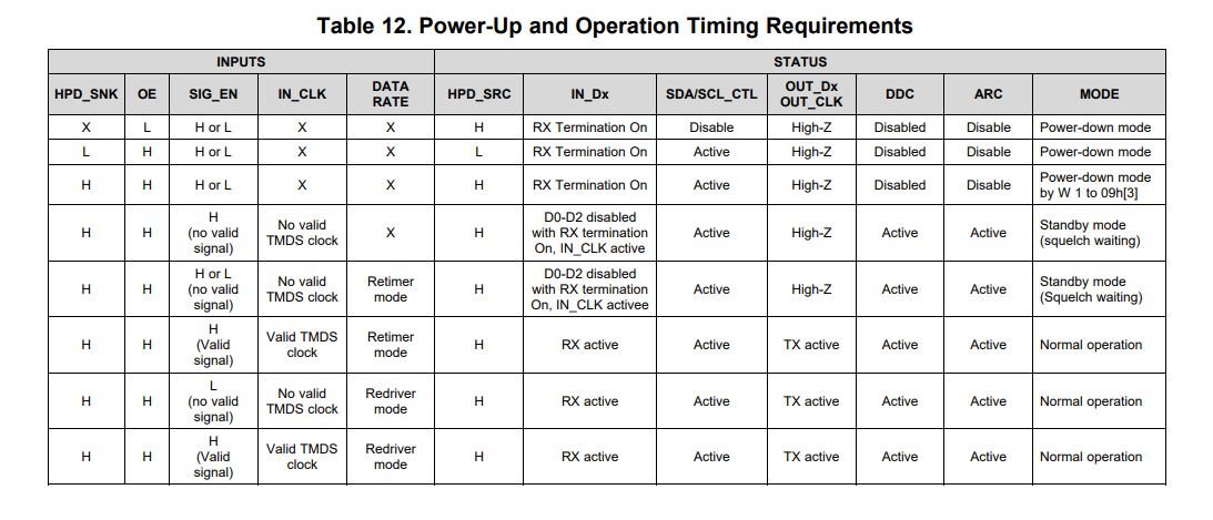

    Below are the conditions that will place the TMDS181 into power-down or standby mode.
    Can you please remove R108 and just have the 0.22uF on the OE pin? The TMDS181 already has an internal pullup and there is no need for the external pullup resistor.
    Can you measure the 1.1V, 3.3V, and OE to make sure the OE goes high after the 1.1V and 3.3V go high? I want to make sure the TMDS181 is getting properly reset.
    David
