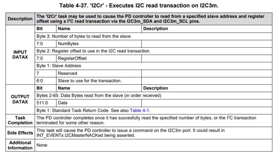

Hello , we would like to read redriver settings with "I2Cr" command , but i cant find the documentation anywhere.
In this post I found the documentation for "I2Cw" command , could you please add the documentation part for the "I2Cr"?
Eriks
  • Hi Eriks,
    I can share with you the table for I2Cr, you can use this command in the same format as I2Cw. This section will be included in the next update for the document.

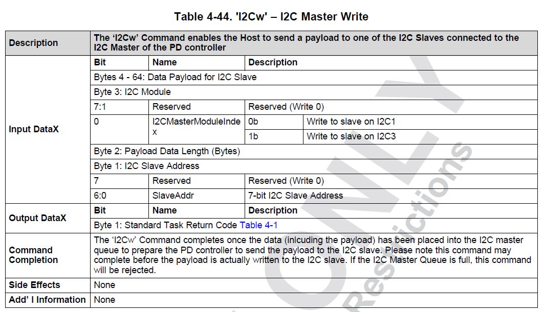

  • Hello ,
    We are testing this command, but it doesn't seem to work , as i understand this command is for I2C3 master , but we are using I2C2 as slave and I2C1 as master, can we use this command to read from I2C1 master? And if no , is there a different command to do this?
    Eriks
  • Hi Eriks,
    This command should still be working on the other I2C port as well if it is set as Master. Could you attach your project file so that I could take a look at them?
    Did the I2Cw 4CC command work using the same format?
    Thank you,
    Hari
    Here is the project file: tps65987.pjt
    The I2Cw command works as expected ,for I2Cw command I used this
    as you can see the structure of the command is different, on byte 3 you select which master to use unlike I2Cr command.
    Eriks

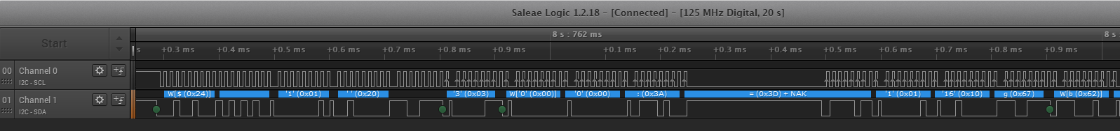

    We did some more tests with "I2Cr" command.
    To start we used the "I2Cw" command to write value 0xCC to register 0xAA on retimer that has an address 0x12 . The retimer is connected to I2C1 port and this port is configured as Master.
    We sent 4CC cmd "I2Cw" on I2C2 port that is configured as Slave.
    Content of Data1 register before sending "I2Cw" 4CC
    TPS reg 0x09 (64):
    12 2 0 aa cc 0 0 0 0 0 0 0 0 0 0 0 0 0 0 0 0 0 0 0 0 0 0 0 0 0 0 0 0 0 0 0 0 0 0 0 0 0 0 0 0 0 0 0 0 0 0 0 0 0 0 0 0 0 0 0 0 0 0 0 0 0 0
    Note ,the picture is taken on I2C1 port and device ACK successfully.

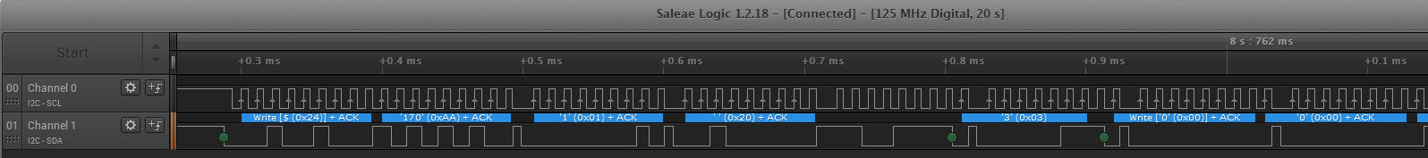

    Now we tried to use the "I2Cr" command to read one value from register 0xAA
    Content of Data1 register before sending "I2Cr" 4CC
    TPS reg 0x09 (64):
    12 aa 1 0 0 0 0 0 0 0 0 0 0 0 0 0 0 0 0 0 0 0 0 0 0 0 0 0 0 0 0 0 0 0 0 0 0 0 0 0 0 0 0 0 0 0 0 0 0 0 0 0 0 0 0 0 0 0 0 0 0 0 0 0 0 0
    As you can see the "I2Cr" command does not work correctly , the first 2 bytes are correct, but then it sends the number of bytes we wish to read and then just reads a lot of junk data .
    Any help would be appreciated .
    Eriks

  • Hi Eriks,
    I think that you may be running into issues in the second part of this process.
    1. You will first write the I2Cr CMD
    2. Then you will read the CMD register to verify CMD
    3. Then you will read Data1 register.
    I have attached an example that goes through this in more detail. You will need to update your slave address and register address for your implementation. Please try that and let me know your results. Column S gives more detail to each step.
     I2Cr_4CC_cmd_example_987.xlsx
    Emma
