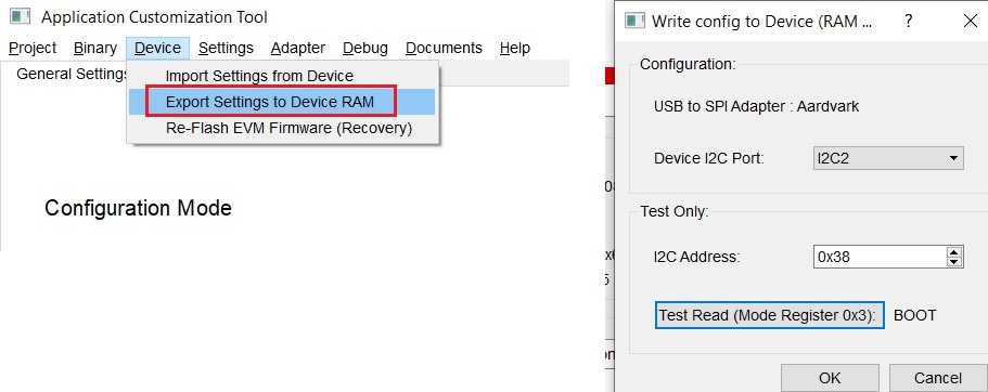

Your photos did not attach. What do you mean export settings to device RAM?
Emma
Hi Jack,
Can you explain what you are trying to accomplish with this feature? I think that there is a different method you should use if you are trying to configure your device. I can better help point you to this if you break down what you are trying to do.
Also, can you please try I2C1 and let me know your results?
Emma

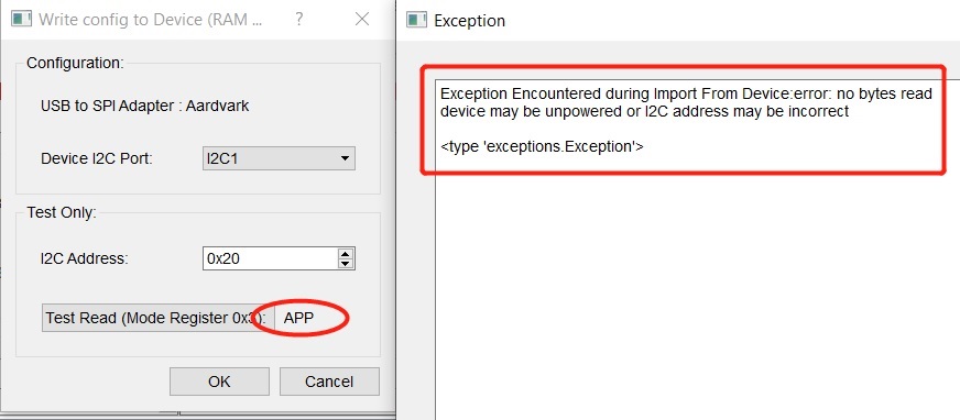

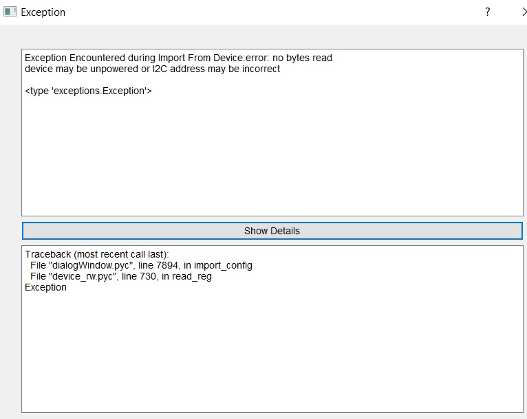

Hi Emma,
I tried:
1, Flash erase, then The PD controller become APP, see below picture
but Export settings to Device RAM still failure!

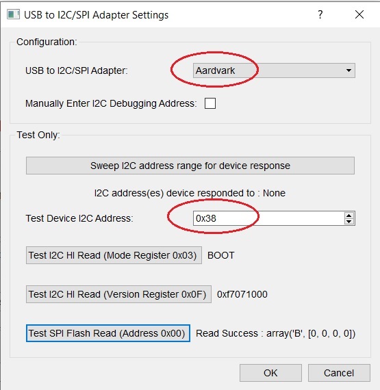

To check that you have the correct I2C address in the GUI please do the following:
- Go to the Adapter tab in the GUI
- Configure I2C/SPI Adapter Settings
- Sweep I2C address range for device response
- Start
You should see the following, which tells you that I2C1 has the correct address:
Once you have confirmed your adapter, please flash your device by the following method: Binary > Flash from current project. Power down the device. Then go to the debug mode, and check the mode register. Let me know your results.

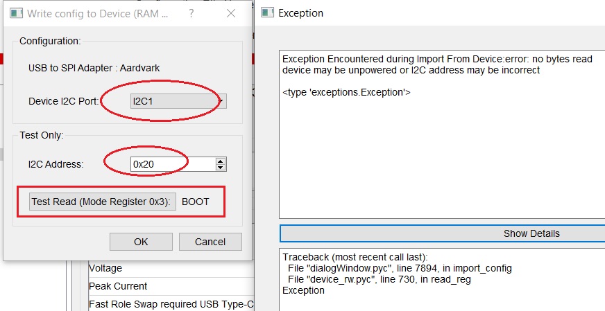

Hi Emma,
Thank you very much for your support.
I try in my side again, still in BOOT mode.
But if I short SPI_MISO to GND, same as press S3 on the EVM, TPS65987D can enter APP mode.
I use Winbond W25Q80DVSNIG, which near W25Q80JVNIQ.
Any idea?
thanks,

Hi Jack,
Can you flash your project to your device in APP mode using the method described above and then restart the EVM? I was able to verify your project is compatible with an EVM. You should not need to restart the microcontroller or short SPI_MISO to ground for this solution to work.
Emma
