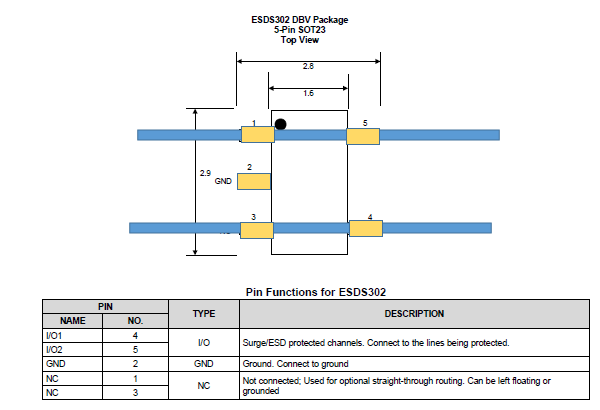

Hello team,
My customer is considering the below pattern.
Is there a problem on this pattern?
Shotaro

Hi Shotaro -
Yes, the pattern your customer is considering is fine and recommended.
While we don't have an example in the datasheet, we refer to this in the first page of the ESDS302 :
