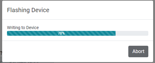

Hi team,
I'm using TPS25750EVM connect with the GUI. I have tried both the online GUI and offline GUI. Neither of them could connect to the EVM. I have also another colleague. Neither could he connect to the EVM. Could you help advice how to connect to the GUI?
Thanks and Best Regards,
Will
  • Will,
    What issue are you seeing with connection? Based on your screen shot it looks like everything is connected appropriately.
    The status bar at the bottom of the screen has several different states:
    1. If TI Cloud Agent is not installed, you'll see the following message
    2. If there's no hardware connected at all, you'll see the following message
    3. If there's a valid connection over an open COM port to the hardware, you'll see the following message
    4. Once you fill out the questionnaire and click on the Flash To Device From Current Configuration, you'll see the following message
    Along side a modal that showing the flashing progress
    Robert
