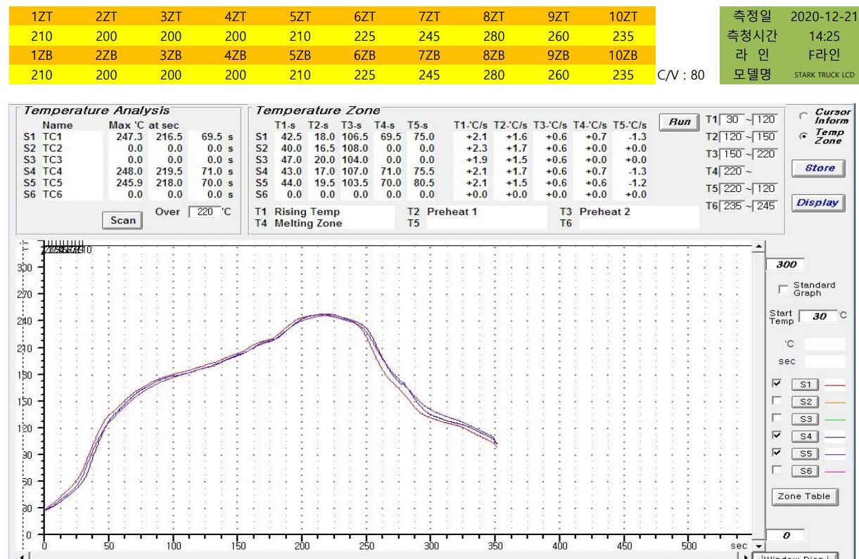

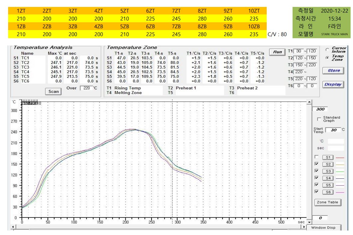

  • Hi, Aaron
    Thank you for your answer.
    The figure below is the reflow condition actually applied to production.
    Please check if there are any problems.
    The material applied to the production is Pb-Free.
    Thanks.
    MJ
  • Hi MJ,
    Thanks for sharing the profile. As I mentioned on previous posted, there is no issue if you are using the standard reflow as long as you are not exceeding the maximum temperature. Time within 5 °C of the specified classification temperature; Sn-Pb Eutectic Assembly-20 seconds maximum; Pb-Free Assembly-30 seconds maximum.
    Aaron
