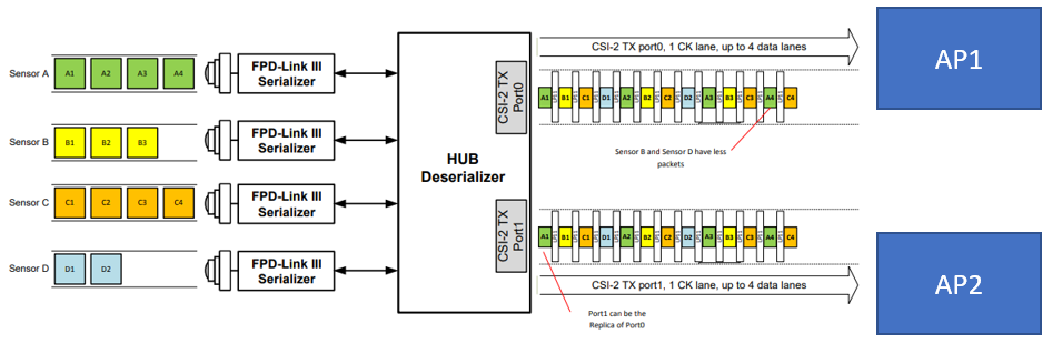

HI,
I have a question about DS90UB960-Q1 CSI-2 Output,
I want to know if DS90UB960-Q1's CSI-2 can output to different AP with the same image data?
HI,
Hello Lin,
Yes, you can do that if you forward all RX data into one CSI output and enable replication on the other CSI output port!
