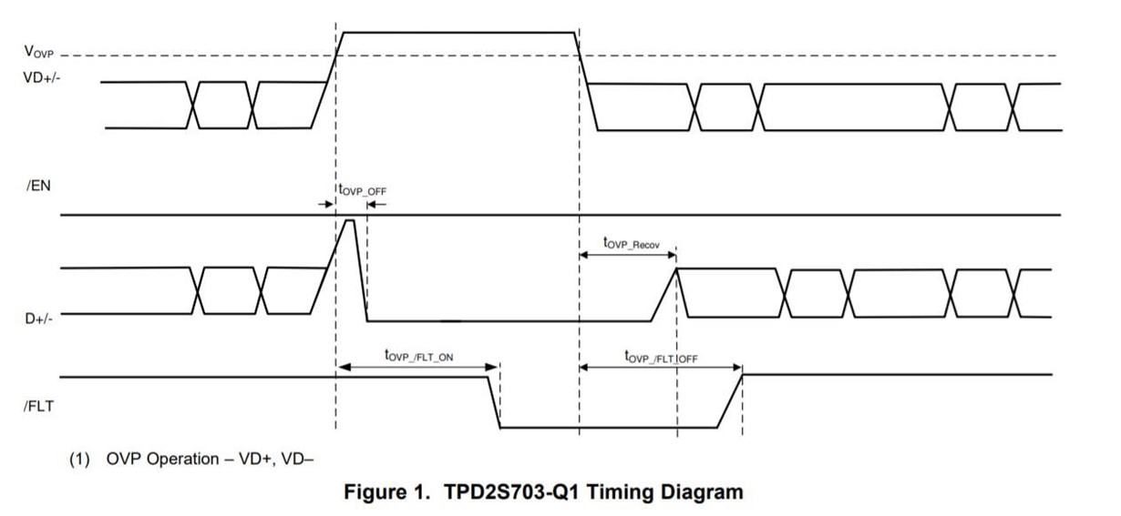

    We have v1 schematic for TPD2S703-Q1. May you help to check the schematic below?
    I have a question about the enable pin. Could we pull low the enable pin by pull-low-resistance as shown below? Is there any risk to damage the components and IC  on D+/D-?
    • The sequence of TPD2S703-Q1 is shown as below. The TPD2S703-Q1 can recover by itself and the over-voltage on D+/- will less than 1us. It seems that it’s safe to the components and ICs behind TPD2S703-Q1.
    Roy
  • Hi Roy,
    Please see the below comments:
    CMC and 10nH inductor should add between the type A port and the TPD2S703 like datasheet shown, And others are pretty good.
    In addition, EN can pull down by a resistor, but EN will be not control on other risks.
    To be ware, when doing the layout the TPD2S703 should put as close as possible to the type A port.
