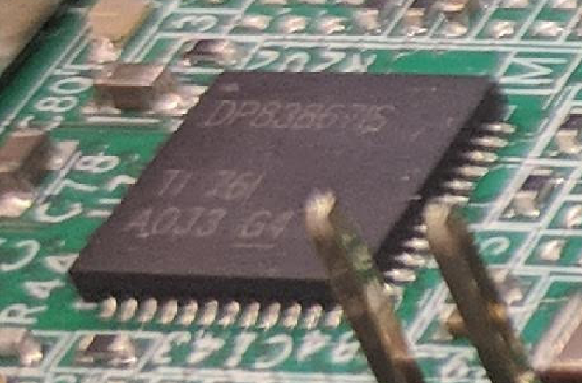

  • Hi Nikhil,
    1.) The USB2MDIO looks useful and I even have a couple of MSP430 launchpads here. However, due to Corona restrictions, I cannot simply enter our office bulding without very good reason. Because of that, I have connected all 5 FPGA boards to a host via Ethernet, UART, and JTAG. So my hope is to solve the problem without physical access to the hardware.
    2.) Keep in mind that the board that has a DP83867IS TI96I ASL4 G4 works perfectly and has the same schematic. And today, I asked a friend who owns another VCU118 board to run my FPGA design and it works perfectly as well. The marking on the TI chip of his board is different again. I cannot read it perfectly due to an unsharp picture (see attached file), but it looks like DP83867IS TI 76I A0J3 G4. Beside that, all boards should have the same schematic. So I would say that it is unlikely that it has something to do with the schematic.
    3.) This is pretty interesting on its own, since Xilinx sells the VCU118 as one of their top evaluation boards. So it is very strange that they do not use a RJ45 connector that is recommended by TI. However, my gut feeling tells me that this alone whould not be a problem, since two boards work perfectly with the exact same connector. When I first discovered that the four boards do not work as intended, I swaped ethernet cables and host network ports to rule out these things as a source of the problem. Since all other factors (schematic, connector, ethernet cable, etc) are known to work with the board that has the DP83867IS TI96I ASL4 G4 chip, I expect that something in the DP83867IS TI95I C1KQ G4 chip seems to cause the problem. Indeed, it can be a specific combination of things which cause the problem only in conjuction with the DP83867IS TI95I C1KQ G4 but not with the other two DP83867IS chips (mine and that of my friend) I tried out.
    I really hope that someone from TI finds out what the problem is and how it can be fixed.
    Thanks again and best,
    Nico
