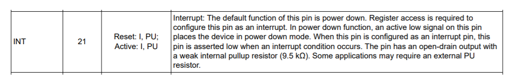

DP83826I: INTpin in BASIC MODE
Part Number: DP83826I
Hi Team,
My customer has selected BASIC MODE.
Isn't the description of INT pin in the datasheet wrong?
In BASIC MODE, pin 21 is assigned to INT.
I understand that INT is Output.
In ENHANCED mode, the PHYSCR Register [bit0] can be set to OUTPUT.
 1h = INTR/PWRDN is an interrupt output
