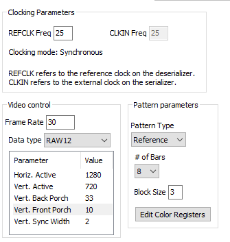

As mentioned in my previous post, I have First Sensor camera, containing DS90UB953 Serializer, connected to DS90UB960 deserializer hub. I can generate YUV test pattern on deserializer and display it on screen, but when I try the same settings on serializer pattern generator (hub is set to forward only one camera) I get no image. RX_PORT_STS2 on hub is having LINE_LEN_UNSTABLE set to 1.
1) What could cause this field to be set to 1. If the cause is incorrect setting for pattern generator, can this be ignored and the image still be outputed from deserializer hub?
2) Can the example code for pattern generator from DS90UB960 datasheet (7.5.12.4 Code Example for Pattern Generator) be used in DS90UB953?
3) Does anyone have example of how the registers should be set for DS90UB960 (deser) and DS90UB953 (ser) to output serializer test pattern.
Sidenote:
-the hubs FPD3_MODE field in PORT_CONFIG register is set to RAW12 High Frequency Mode as per guide from First Sensor. If I set it to CSI-2 Mode, the serializer disappears from I2C bus.
-the targeted spec for test pattern image is 1280x720@30fps YUV or RAW12 format

    I suggest downloading our Analog LaunchPad tool. There's a PatGen tab in the 960 profile that you can use to configure different patgen parameters. The patgen registers between the 953 and 960 are the same, except you won't program this WriteI2C(0x33,0x01) # CSI0 enable on the 953.

    My second question is could the problem be in the incorrect settings for test pattern, precisely vertical back and front porch, and sync width. I left those as they were in the LaunchPad tool since I'm not sure to what values they need to be set (image attached below).

  • Hi Martin,
    If your lock is stable then I'd like to check your pattern setting, could you provide your desired parameters and I can try to generate a script for you? Are you only generating pattern on one serializer?
    - Total and Active Horizontal and Vertical Resolution
    - Frame rate
    - Data Type
    - VC ID?
    - Which RX port is the serializer on?
    Jiashow
  • I've found where the issue was. The virtual channel ID mapping on the DS90UB960 deserializer was wrong. Now I can capture the image from serializer.
