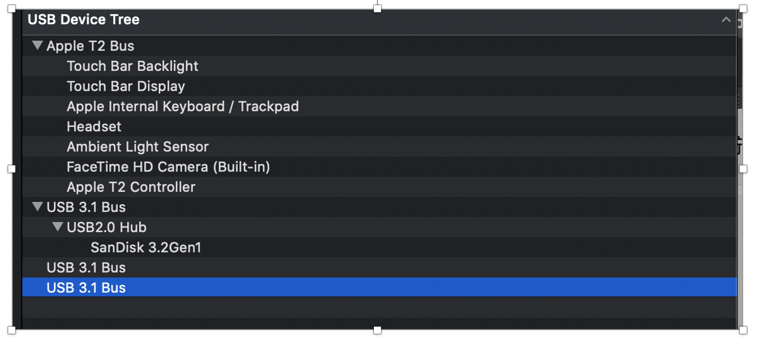

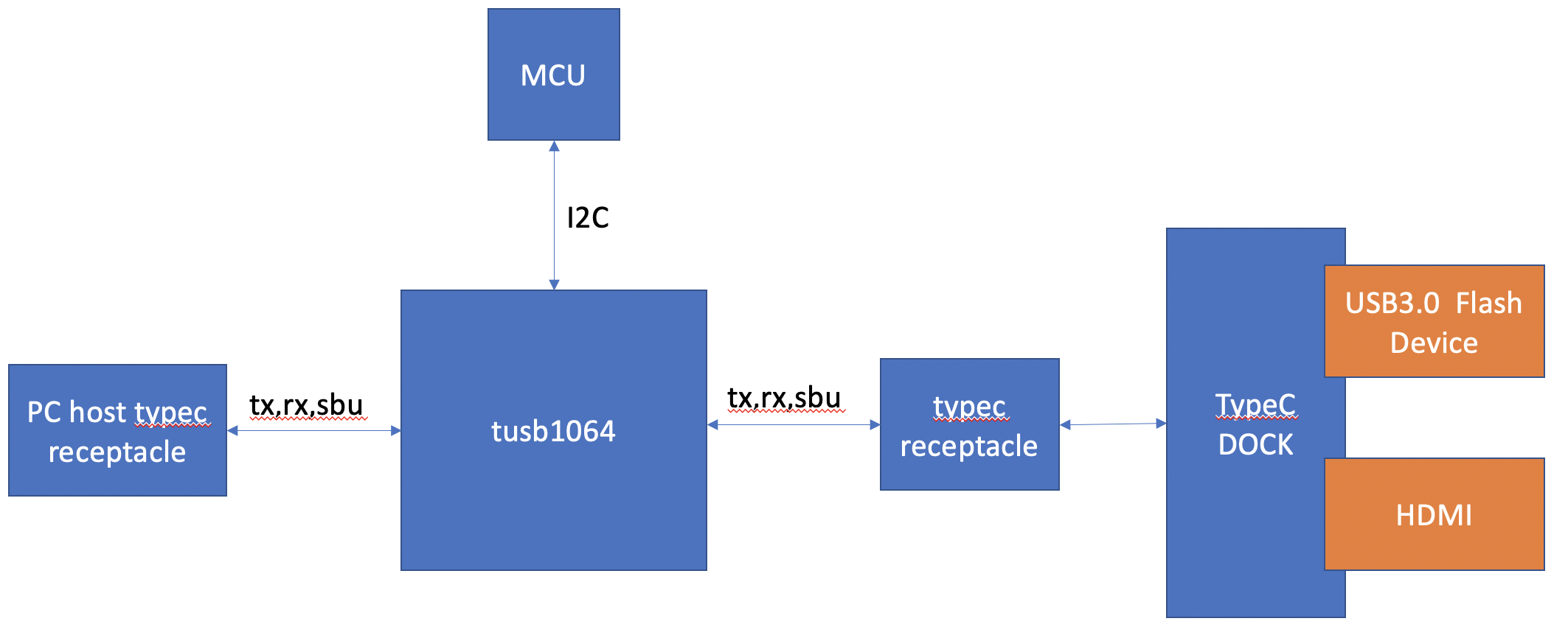

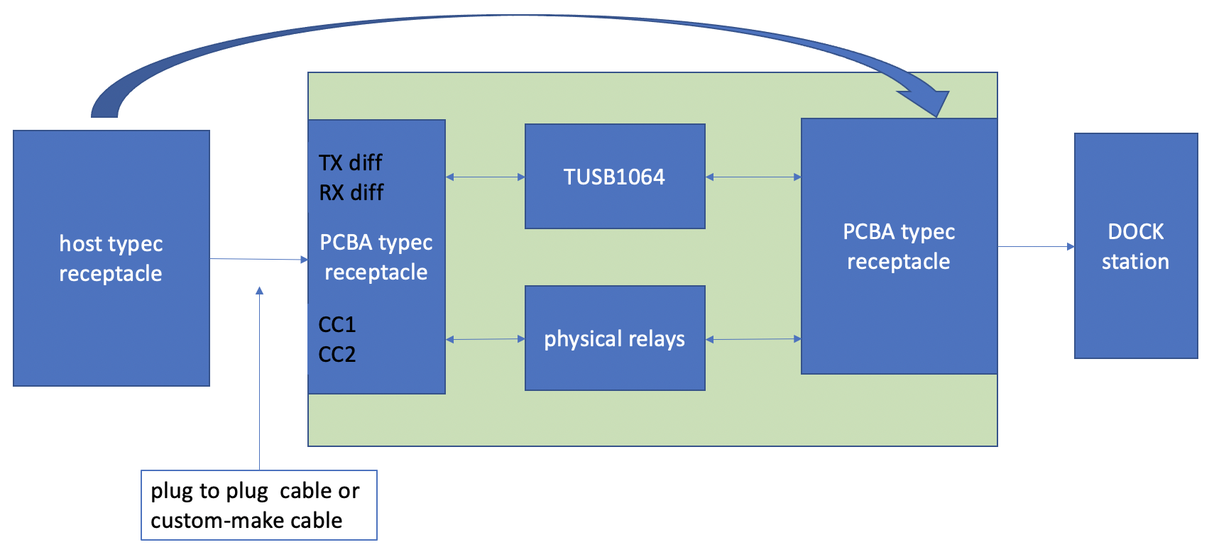

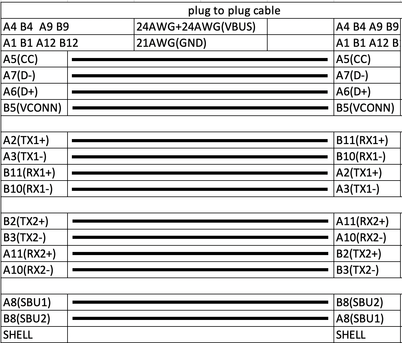

when the tusb1064 device configure the USB 3.1 and two line DP, the DP interface worked well ,but the USB 3.1 Flash Device cannot enumerated at USB3, it enumerated at USB 2.0. so How can I resolve this problem. Thanks
below is the system diagram .
