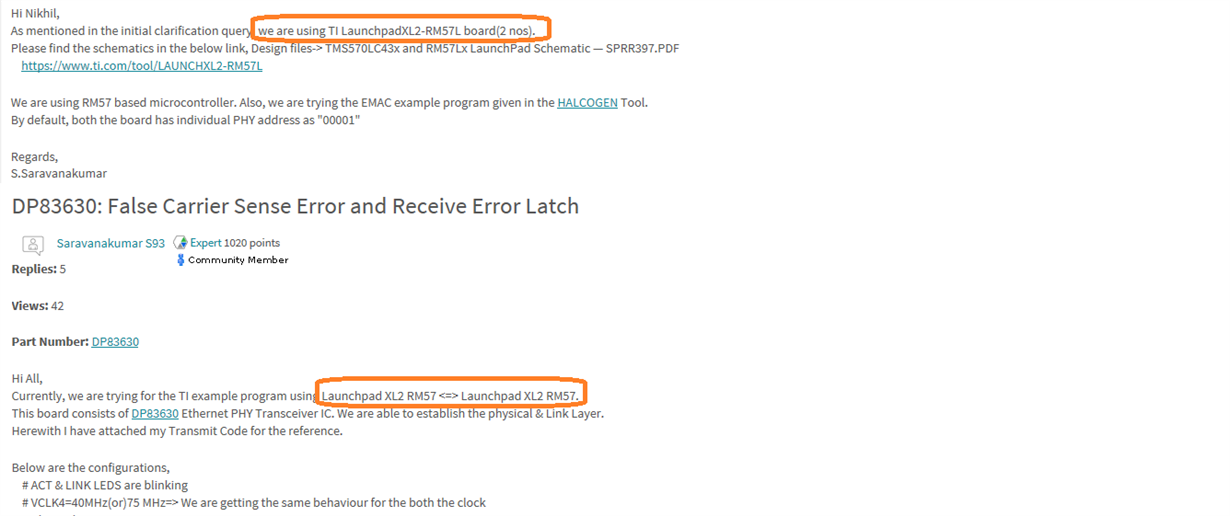

Hi All,
Currently, we are trying for the TI example program using Launchpad XL2 RM57 <=> Launchpad XL2 RM57.
This board consists of DP83630 Ethernet PHY Transceiver IC. We are able to establish the physical & Link Layer.
Herewith I have attached my Transmit Code for the reference.
Below are the configurations,
# ACT & LINK LEDS are blinking
# VCLK4=40MHz(or)75 MHz=> We are getting the same behaviour for the both the clock
# Channel 0
# BROADCAST addressing
# MAC ADDRESS(Point to Poin.There is no IP address configured as of now. Sending the packets in Broadcast MAC address)
# Phy address=0x01 for the both the launchpad XL2-RM57
