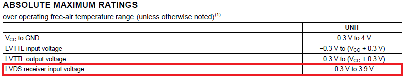

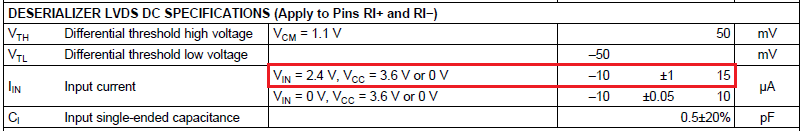

    The datasheet shows the following so I believe we should measure input current in this case.
    Is my understanding correct?
    In addition, Is it possible for you to confirm if there is a leakage current path from LVDS receiver input to VCC?

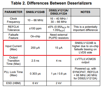

  • I found the following with the application note you attached.
    So, I believe the following red part in SN65LV1224B datasheet is typo.

  • Hi Yaita-san,
    No, that Input Current in the application note is referring to the LVCMOS/LVTTL input current.

  • Hi I.K.-san,
    Is it true? I have thought it refers serial data input because SN65LV1224B has an on-chip fail-safe circuit that drives the serial input.

  • Hi Yaita-san,
    Good point. Depending on how the failsafe biasing is generated internally, it may or may not introduce additional leakage from I/O pins to VCC.
    Design is looking at this but needs more information. Can the customer measure the leakage current that is sunk through LVDS input pins at the following 2 cases?
    • Un-power LV1224B with VCC floating
    • Connect VCC of LV1224B to ground
