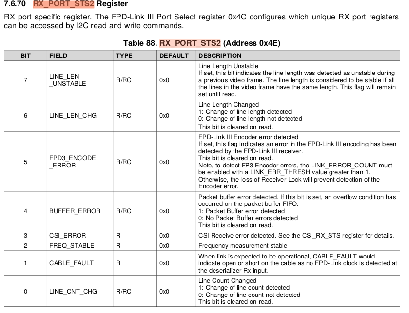

I'm writing to You to clarify some of my questions regarding the way how FPD-Link III frame sequence errors shall be monitored.

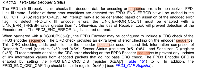

First of all, the deserializer specifications states that:
So as far as I understand, FPD3_ENC_ERROR bit will be latched as far as the FPD-Link III receiver detects encoding or sequence error, then:
We can read FPD3_ENCODE_ERROR bit and it indicated that FPD-Link III  encoding error has been detected.
My question is how can we distinguish encoding error from the frame error, or both refers to the same error?
  • Hello Piotr,
    Encoder error and sequence error are both flagged by FPD3_ENCODE_ERROR. There is no way to distinguish the two types and they are not exactly the same, but functionally both types of error indicate a detected issue with the FPD-Link FC signal recovery.
