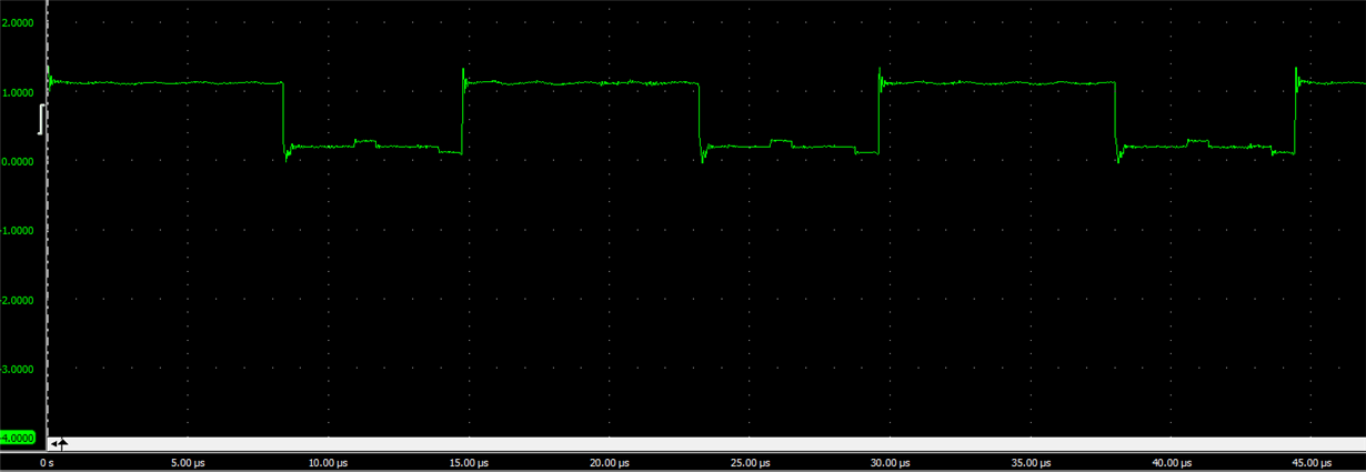

  • Hi Casey
    Thanks for the info.
    Could you confirm that the image below looks correct? I probed the p signal of one of the data lines. I am afraid the the scope I have isnt high bandwidth but it does give the general look of the signal. I am still not getting any packets received by the FPGA and so just want to know if the MIPI port is working.
    I assume that I dont need any cameras attached when using the pattern gen?
    Jon
  • Hello Jon,
    The waveform does generally look like a DPHY transmission, yes. However you do need to make sure you are programming the items I mentioned in the previous post to ensure that the TX output characteristics are going to be within compliance for the DPHY standard. You do not need cameras attached to exercise patgen.
    Casey
