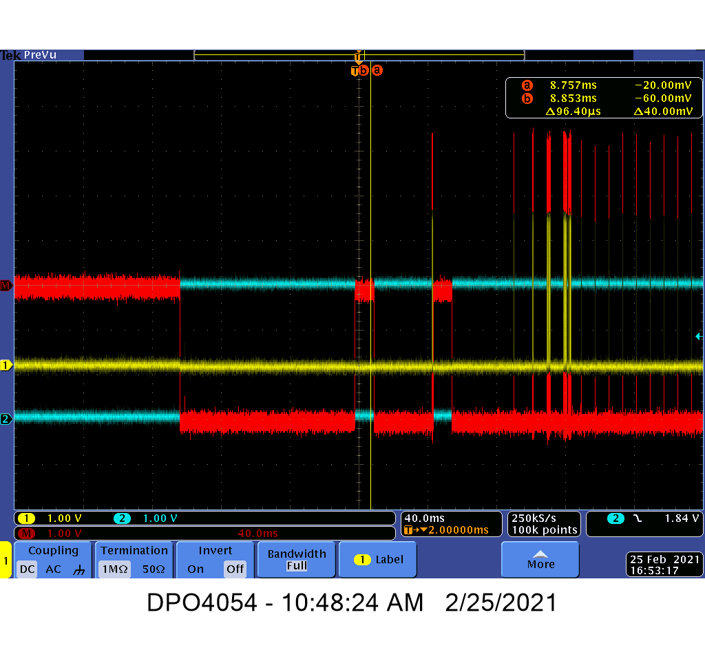

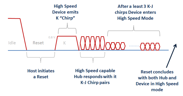

The failure is during the high speed device detection and speed negotiating phase. Testing on a Windows 10 PC reports a "Device Reset Error". I have looked at the signals on DP and DM with a scope and also connected a USB protocol analyzer to debug. This is what the typical high speed detection should look like:
And this is what I see on working ports.
On a failed port I see:
1) The initial IDLE state with the device pulling DP high and DM is low. This is OK
2) The TUSB4020BI hub then drives DP low with DM still low to start a reset. This is OK
3) Our HS device then responds with a K chirp of about 2mS. Device drives DP low and  DM high, this is OK
4) The TUSB4020BI hub should then respond with K-J chirps on both DP and DM. This is where the failure appears to be. I only see the host K-J chirps on DP. DM is silent. It is almost as if the TUSB4020BI cannot drive the DM signal. The DP drive output seems to work OK.
We do have a ESD protection device on DP/DM (TPD2E2U06DRLR) but I removed it just in case it was the problem. Did not help and still have the failure. Nothing else is connected to DP/DM so it seems to be a failure in the TUSB4020BI DM output.

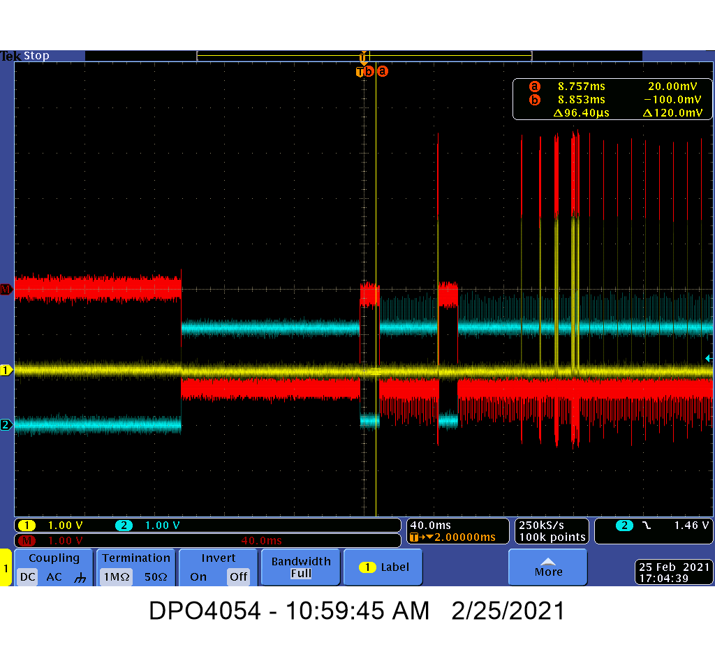

  • Attached is the picture I thought was inserted in the the original post.
  • This is a scope capture of a "good' connection on my HW. Yellow = DP, Blue = DM and Red is the differential DP-DM. Note the good K-J chirps after the long device K chirp.
    And this is a failed connection. Note the lack of K-J chirps on the blue DM signal after the long device K chirp. DP K-J chirps look OK.
  • Hi Paul,
    The DM line looks damaged.  Can you try connecting a low speed device to the port (USB mouse) and capture what happens on the bus?  Also can you ohm the DM line to ground on a good port and on a bad port - without any downstream devices connected.

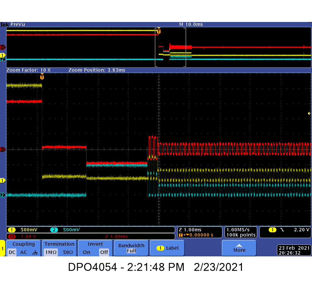

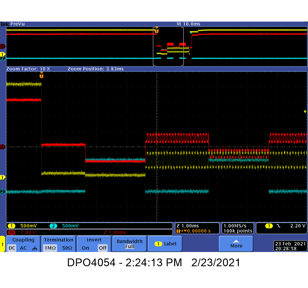

    Thanks for the quick response. I connected a Low Speed (LS) Mouse and it connects and works on both good and "bad" downstream (DS) ports. But there are obvious differences.
    Here is a LS mouse connection on a good DS port. Again Yellow = DP, Blue = DM and Red is the differential DP-DM. On mouse connect (first transition) the mouse pulls DM high to signal a LS device. DM goes to about 3.3V here. Hub then drives DP/DM low to start a reset and proceeds form there to connect and enumerate OK. Both the DP and DM signals can drive to full 3.3V.
    Here is the same connection on the "bad" DS port. The signalling and timing look the same, but note that the DM signal can only drive to about 2.3V instead of 3.3V. So definitely looks like extra loading on the bad port DM line. But I guess it is still good enough for the LS logic to work and allows the mouse to operate at LS on the bad port.

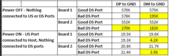

    I also measured the the DP and DM resistance to ground as follows on two PCBAs, both with one good port and one bad port. DM lines on the bad ports are definitely lower than the good ports. Readings that look different to me are highlighted in yellow.
    To summarize:
    1) Low Speed device works on both good an bad ports but DM voltage levels on the bad port are low and seem to have extra loading on them.
    2) High speed device will not connect on bad port. The extra DM line loading seems to be too much for HS to work.
    3) Resistance readings on the DM line of bad ports are low.
    So question now is what could cause this? And how to prevent it in the field?

  • Hi Paul,
    Yes, it seems like some sort of EOS event, but it would be hard to determine what voltage or duration.  Can you check a few of the other bad units to see if the damage is consistent to DM on other boards?  That would indicate that there may be one particular node that is causing issues rather than it being randomly occurring.
    JMMN
  • Hi JMMN,
    I checked a third board and this one has a low ohm reading on the DP signal (about 10K instead of 20K as the other signals). So the issue does not seem to be confined to just the DM signal. Looks like the damage can randomly be either USB data line. Thus doubtful that a particular node caused this. That would be very low probability anyway the way the nodes are used in inserted into the racks.
