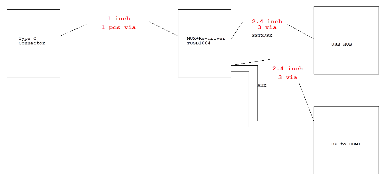

my customer will use TUSB1064 and layout as below diagram. Does it would be okay?

for high speed signals, it's better less and equal to 2 vias
Hi Brain,
Thanks for your quick reply.
I know that the maximum vias is 2 in datasheet, but the maximum trace length on the specification is 12 inch, currently my trace length is 3 inch.
Can this compensate for the loss of one via ?
Hardy
if they do need 3vias because of 3 in trace, make sure the stub on each via as short as possible.
