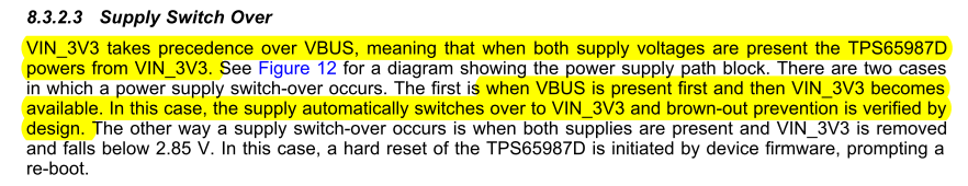

from datasheet 8.3.2.3, when both VBUS or Vin_3v3 are present, 987D will get the power from VIN_3V3.

it seems that the power is from VBUS or VIN_3V3 which is present first, not VIN3V3 has higher priority.
something wrong in my test?

  • Hi Frank,
    Your attachment doesn't go through, but I think I understand what you are seeing.
    When you set ADCIN1 to BP_WaitFor3V3_Internal, the dead battery flag is still high thus it's using VBUS power source. You will need to clear the dead battery flag either by DBfg command or GPIO Barrel_Jack_Event to power from VIN3V3.
