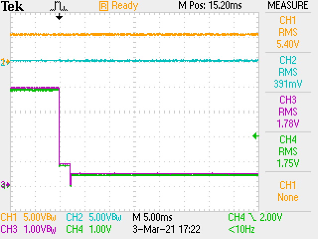

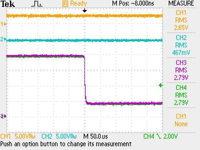

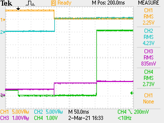

TPS25820: TPS25820 does not source power
Part Number: TPS25820
Other Parts Discussed in Thread: TPS65987D

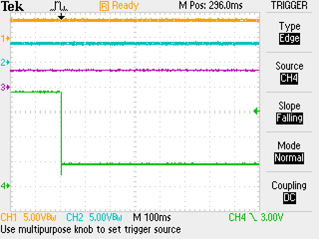

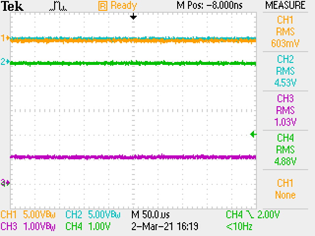

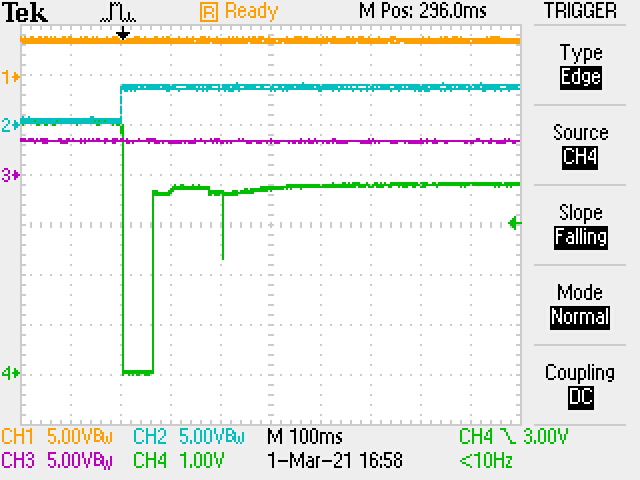

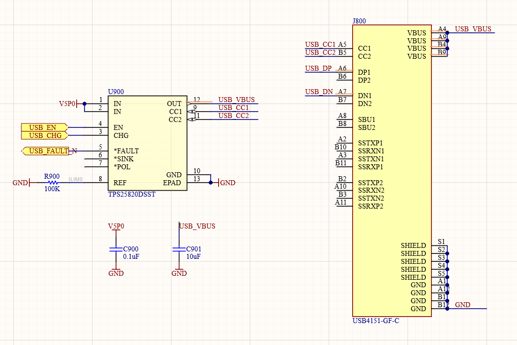

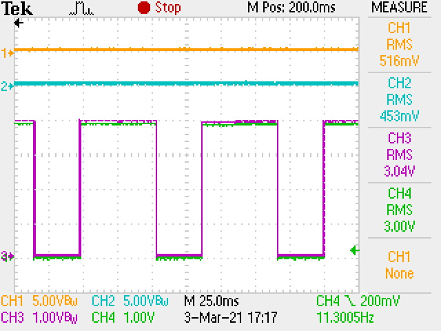

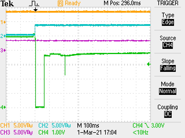

TPS25820 does not power
Ch1 = FAULTn
Ch2 = SINKn
Ch3 = POLn
Ch4 = CC2
Device 1 = Moto X (USB C)
Device 2 = Lenovo TabM10 (USB C)
IN = 5.0V
Rref = 100k
If CC2 is manually forced to ground, the device charges normally.
What might cause such behavior?
Thanks!
Device 1 connect
Device 1 disconnect (after CC2 manually grounded)
Device 2 connect
Device 2 disconnect (after CC2 manually grounded)
