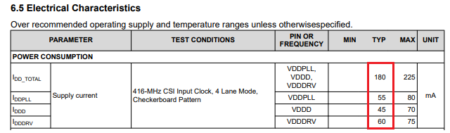

Part Number: DS90UB953-Q1
Hi Team,
Is the following 180mA typo?
(55+45+60=160mA)
My customer wants to know it.
Yaita
Hi Team,
(55+45+60=160mA)
Yaita
Hello Yaita,
you are correct, this should be a typo. The Typical total is 160mA
