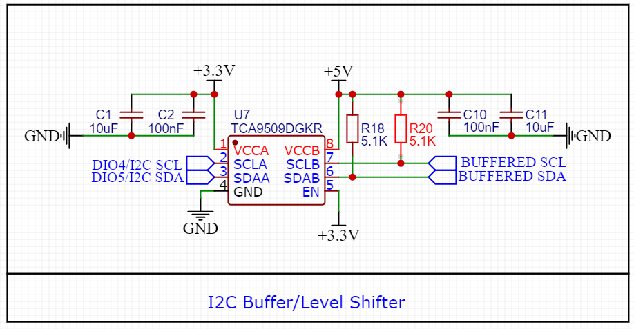

Hi Sir,
A customer have a TCA9509DGKR I2C buffer in his application,
but he is unable to get a response from the B side.
The problem is nearly identical to the one here:
e2e.ti.com/.../737445,
except he has A side connected to 3.3V.
He has verified through both oscilloscope and logic analyzer that his MCU is sending I2C signals and they are arriving at the A-side.
The MCU is a CC1352R。
I can not find any deviation in his schematic, VCCA<=VCCB-1V.
is the issue on pull-up resistors or running at 100kHz instead of 400kHz?

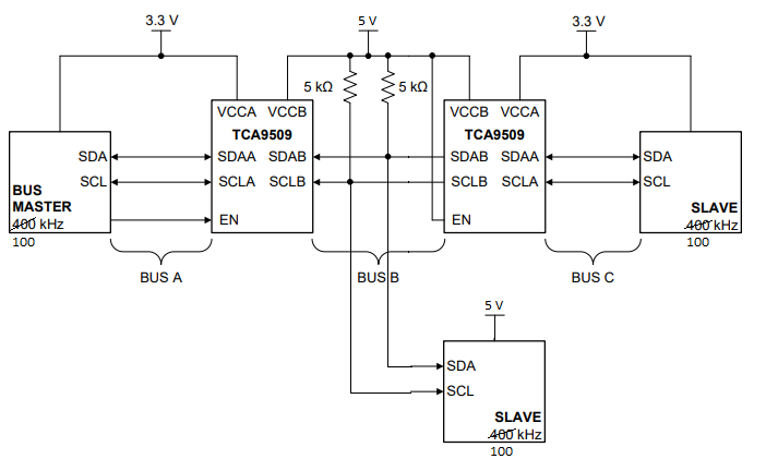

The attached diagram that represents the topology of customer's design.
The minimum switching frequency of the TCA9509 is 400 Khz. However, the MCU you chose is able to output at 400 Khz, so you could try increasing the frequency and seeing if the device works. You should also verify that there are no pull up resistors built in to the I2C pins on the MCU. I read through the datasheet and it looked like there weren't any.
If that doesn't work there may be an issue with the pull up resistor sizing and the VOL of the device. We can look into that if that is the case.

I was able to take some more measurements, and found that turning the frequency up to 400kHz did not solve the problem.
Looking with my oscilloscope, I see that the CC1352R is pulling the lines down to approx. 250mV. This does fall within the recommended operating conditions for VIL on the A side (0.3V MAX)
I tried modifying my code as in e2e.ti.com/.../875117 to provide more drive strength (I even removed the PIN_PULLUP config), but the VIL A-side value did not change at all, and the B side was still inactive.
I also removed the slave that is connected to the B side in my design, so it is just like Figure 6 in the datasheet, except the A sides both have 3.3V and the B sides have 5V. This still didn't change anything.
I have changed the chip and checked all of my connections, so I'm truly at a loss here. Any suggestions would be much appreciated.
