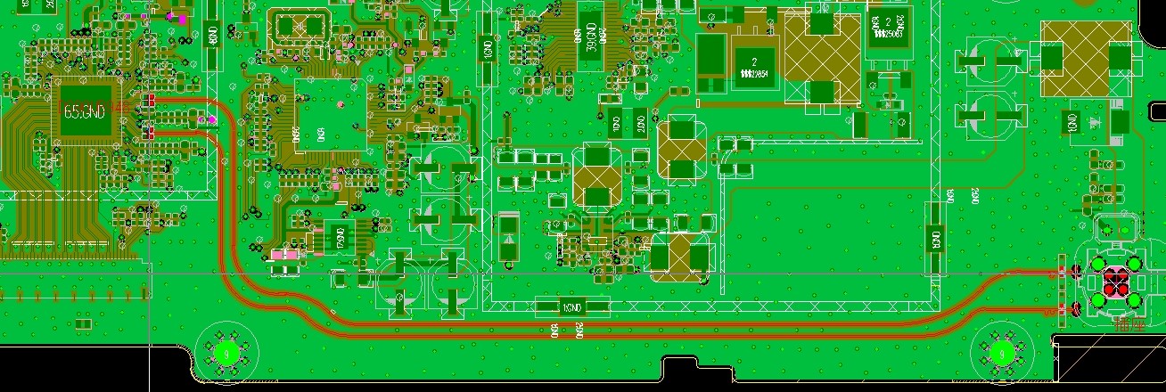

Hi team,
we have two questions about the routing between RIN and connectors. customer use 100ohme differential trace. since the board size limit, the PCB distance between RIN and connect is up to 170mm, we have concern about that.
can you help on below items:
1. ate there requirements about routing length between RIN adn connector? any risk if the length is 170mm.
2. which patameters can be used to measure the infuence of  the routing length on the LVDS signal?
attahed layout picture:
