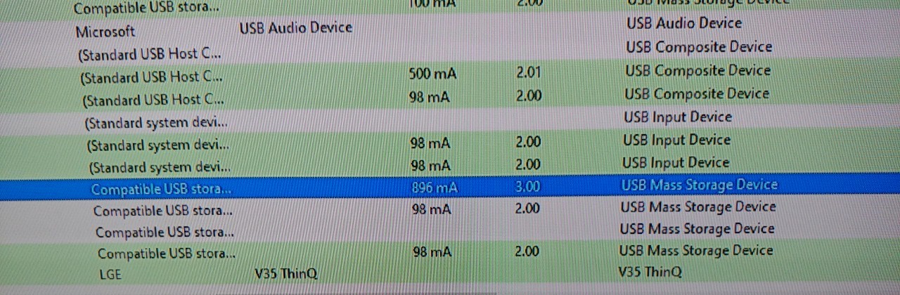

    In the meantime, I think I have a strong clue that it's SanDisk firmware/register related. Every one of this model that I plug in reports as shown below.
  • Is that report from when the flash drive is directly connected to the host?  It shows a USB 3.0 drive which isn't possible behind a USB 2.0 hub, it should drop to the lower data rate.
    JMMN
  • Indeed, that is the case as reported though. Only that model drive.
    I'm fairly convinced something isn't reporting right on that model flash drive. It would have to be something the motherboard doesn't care about, but the hub hiccups on.
  • Oh, that is strange.  The hub doesn't actually read the data reported by the downstream device, but it could be that the device is taking time attempting the USB 3.0 connection before dropping to USB 2.0 and that is causing a delay during boot.
